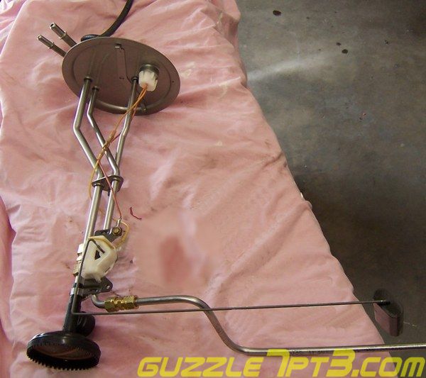

make him check your fuel pressure. there are little screens inside the tank that will plug up and make your life a real nightmare sometimes. and also the fuel line connection on the tank really sucks. it is a quick loc fitting and the o-rings go bad and then you suck air into your fuel line also. the other thing is that the return line from the motor goes into what is called a mixing chamber inside the tank it looks like this.
notice how the return line loops around and ties into the mixing chamber then the fuel supply line sucks from that chamber also. the return usually has alot of air in it also. which can cause your injectors alot of problems over time. if you do the in tank mods it will fix all of this. and then your fuel pickup will look like this
if you do this it eliminates the little screens inside that mixing chamber so they will never clog again. you would also need to put a spin on filter on the frame before the fuel pump to protect your pump from anything that might get sucked up in the tank that the little screens used to catch.
here is a link on how to do this whole mod and what you will need to do it.
