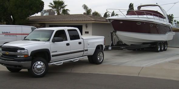

I don't know if it is the largest tire on a 450 here on the board, but I went with 37x13.50x22 Toyos on mine. This combination puts a whole lot of rubber under the rear of the truck. :+)

Hotduck.....I take it you have a lift on your truck??
If I keep the stock wheels I was also thinking 265 would be the largest I would want to go.

Hey Hot Duck, did you put adapters (for 10x225 I think) on for those? or did they make you some wheels to fit the 10 bolt Ford F450 pattern?
I've done adapters before and while I liked the stability of the setup, I didn't like the added rotational weight and unsprung weight. I'm watching for direct bolt on.
This was my trade in for the F450

It is lifted 8". We used a Pro Comp system, but we had to get all of the steering components from Kelderman because the Pro Comp steering parts would not fit the 450.
The only downfall is that I will have problems with the height of the bed sides if I ever go back to a gooseneck trailer. I was towing a 53' gooseneck with it, but I replaced that with a 46' tag trailer just before I lifted the truck. So far I have absolutely no regrets. The truck still tows as well as it did stock, but now it rides better and is substantially better when traveling anywhere off the pavement.

That's a nice looking truck!! Even though the 450 is 10 lug from the factory, I had to use adapters to get the correct lug pattern for these wheels.
