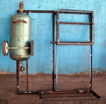

In my first pic I have 4 different totes. The bottom left is my settling tank. I use the 2 top totes to go out and do pick ups with. Well one of the top totes, I havent had a pickup big enough to need both yet. Once I pick the oil up I add 10% rug and let it sit for 2 to 3 days. I then drain off any antifreeze that I may have picked up. After I get the majority of the AF out I drain the top tote into the bottom tote with the clear hose. I have a bulkhead fitting on the top of the bottom tote that has pvc going to the bottom of the bottom tote. This way I can allow the oil to trickle into the bottom of the bottom tote with out disturbing the clean oil that has been settling. In the tote that is on the lower right is all of my waste oil. In here is all of the oil that I have drained off of the settling tote. I am not sure what I am going to do with this oil since this tote was originally full of nasty wvo that was just caked into it. I tried to pressure wash it out without any luck. I am hoping one day the wmo will disolve the wvo and I can drain it and dump it at my friends shop. For now it is a trash oil collection tank. The 2 jugs in front of the lower left tote are full of AF that I drained out of the top tote before I drain it into the bottom one.

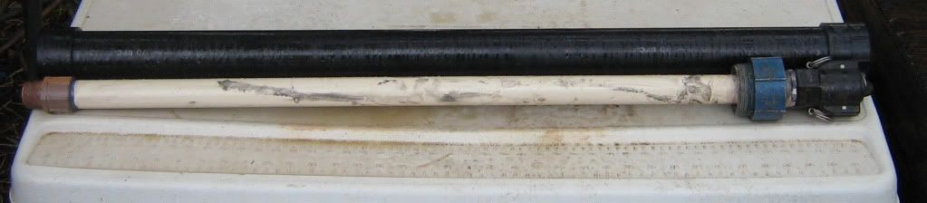

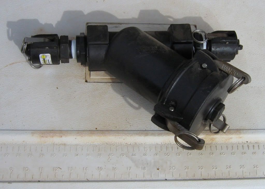

In the 3rd and 4th pic is my pickup pump. When I first started I was using the green filter to do pickups with. It worked great as long as there was no AF in their oil tank. If there was the filter turned most of the oil to chocolate milk for the next couple weeks. That is how I ended up with 2 of the green filters. I was planning on using the second one for pickups but the gear pump was bad so I made my own pump that is smaller, not much lighter but definatley smaller. I used the electric motor from the second green pump and bought a new gear pump and welded up the base to put them together. It is working better this way so I dont get any emulsified oil. Without the filter the oil and water dont mix up.
The base isnt the nicest looking thing in the world but it works good. I ended up using a piece of frame rail from an international truck and it was a PITA to cut with my little plasma cutter.

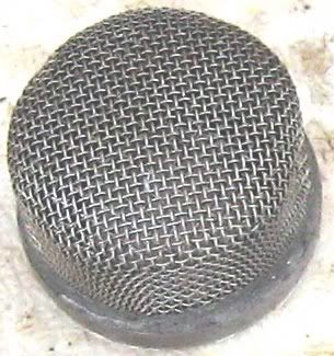

The banjo fittings are great! They y-trap is kind of a prefilter for big pieces of trash. I also have a screen on the end of my pickup tube to keep very large pieces of trash out of the trap. Since allowing the oil to settle for long periods it has helped keep any water or antifreeze out of my water seperator.
Your setup looks quite a bit like mine, except I have two 2" y-traps. The first has a 40 mesh screen in it, the second has an 80 mesh, but if I were to do it over again, the last y-trap would have a 120 mesh screen in it. And, I go to a 20" 1-micron bag filter.

So, what mesh do you have in your y-trap? I like your homemade bag filter housing. So, what size bag did you use, a 20" bag filter, like I used? The housing looks like it could handle a larger bag.

I dont know the dementions on the bag filter. I think it is 32 inches long. I didnt make the filter housing, I bought it used from a local guy that was using it for a fleet of trucks. He used wvo for everything he had, bobcats, trackhoes, dump trucks, and his multiple F550's. The first 2 totes I bought from him, he had over a 150 of them! He had 2 of these green filters and I bought both of them. I only ended up using one of them tho and the other for parts. Here is a newer pic of my pump.
For the y-trap at first I had a 120 screen in it but it would clog way too fast. I wouldnt get but 10 gallons through it and the pump wouldnt move anymore oil. I went up to the 80 screen I think and it works great! The pump doesnt get hit with anything and moves alot of oil, I think about 20 gpm.
I have actually had the 40-mesh screen plug more than the 80 mesh screen after it, but it has never stopped my process, I just increase the pressure up-stream.
I use pneumatic pumping, which means I pump the batch of oil I am going to process into a pressure tank, which is an old compressor tank, then I blend it with gasoline there, and let it settle for a few days to a week, then I drain the sludge off every day. When no more sludge comes off the bottom, then I introduce compressed air at the top, and open a valve at the bottom of the tank, which sends my blend through two 2" y-traps, then to my 1-micron filter.
I also modified the y-traps and Pentek filter housing so that I can back flush them.
I am curious what the guy is now doing who you bought your setup from, because his setup is pretty good. I would only add a cone or domed shape settling tank, and back-flushing the y-traps and filter.

The guy I bought them from sold his business but kept some of his equiptment. He no longer runs what he has left on wvo. All of his trucks had a 2 tank wvo system on them. The track hoes he had ran on wvo strait with no diesel to start up. He said it sounded like crap when it first started but it would run fine in a min or two.
I am not sure what a cone shaped settling tank would help. I guess I would be able to get more crap off the bottom than I can with a tote. I dont use the last 50 gallons of oil in the tote anyway. If I am down to 50 gallons I figure I am out. I am draining 150 gallons into the bottom tank right now. It has been slowly draining since Friday afternoon.
