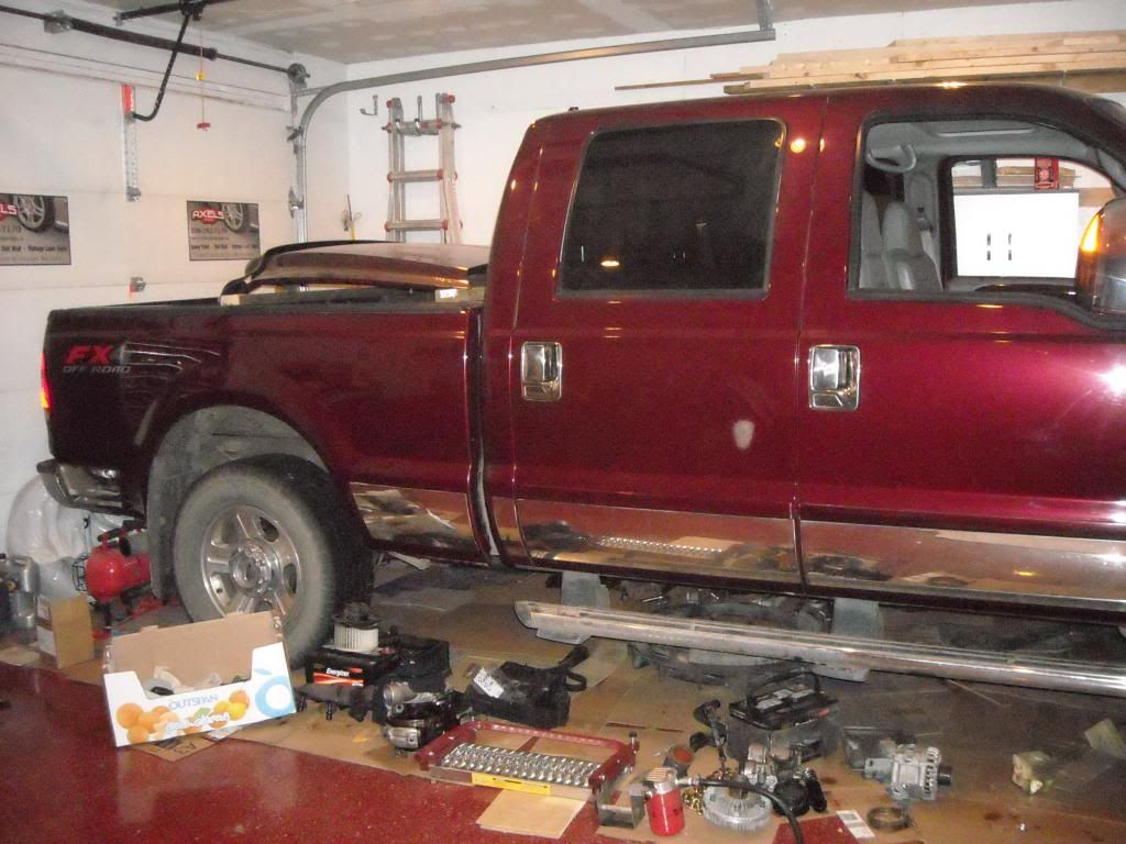

Well, my truck had the head gaskets go so I decided to take on the job of repairing the truck myself. I did not take many pictures of the removal as I was trying to get to the heads quickly and send them off to the shop for repair.
So being fairly new to working on diesels and not wanting to mess this up, I'm going to take it slow, post some pictures of my progress and hopefully get some advice along the way.
So far this is what my truck looks like.
http://www.thedieselstop.com/forums/...dscn1067-2.jpg

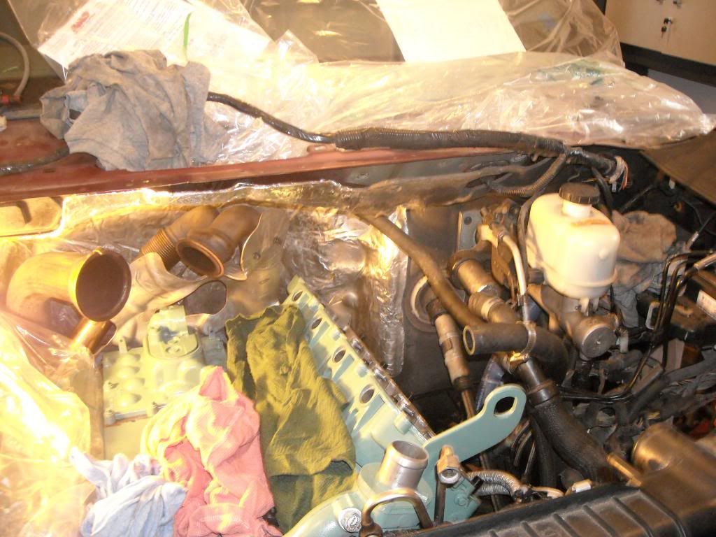

And the engine bay
http://www.thedieselstop.com/forums/...dscn1059-2.jpg
I hope I'm not in over my head.

Seems like you have a nice shop set up there. How did you deal with getting the rear head bolts off ? Seems to be one of the biggest issues to deal with.

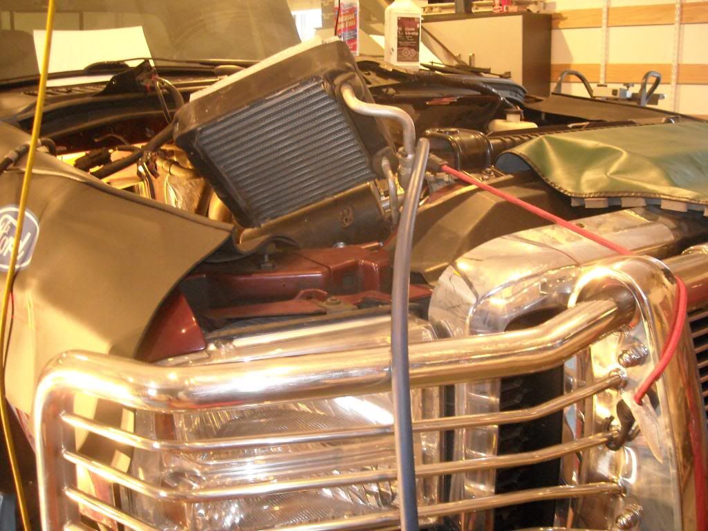

Today was the start of cleaning, prepping and painting of some parts.
Here is a picture of the AC unit moved to allow for access.
Engine cleaned and ready for a little paint.
http://i1278.photobucket.com/albums/...ps3c791a0d.jpg
A picture of the frame painted. I used a rust converter the a rust encapsulator from Eastwood, seemed like a good product, will be hitting it with some undercoating.

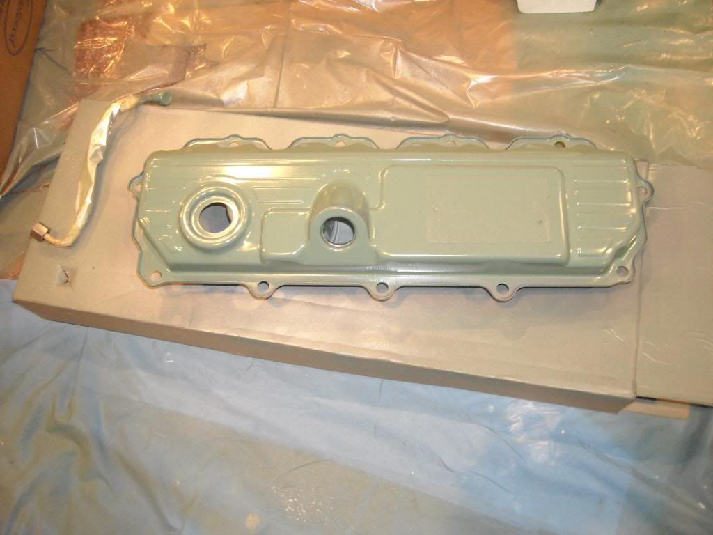

Painted valve cover. Going with Dupli-color Detroit Diesel Alpine green.

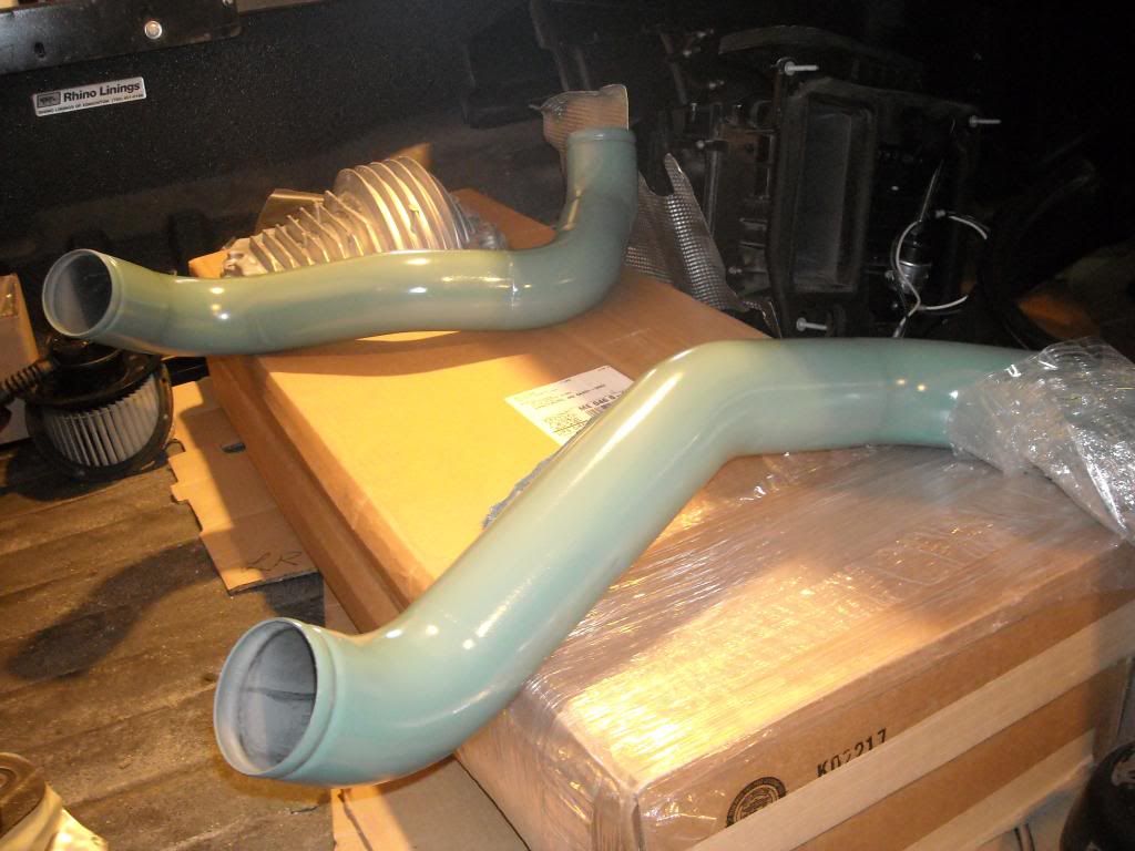

Upgraded from plastic CAC tube to metal
My heads are still out, I hope to get them back next week.

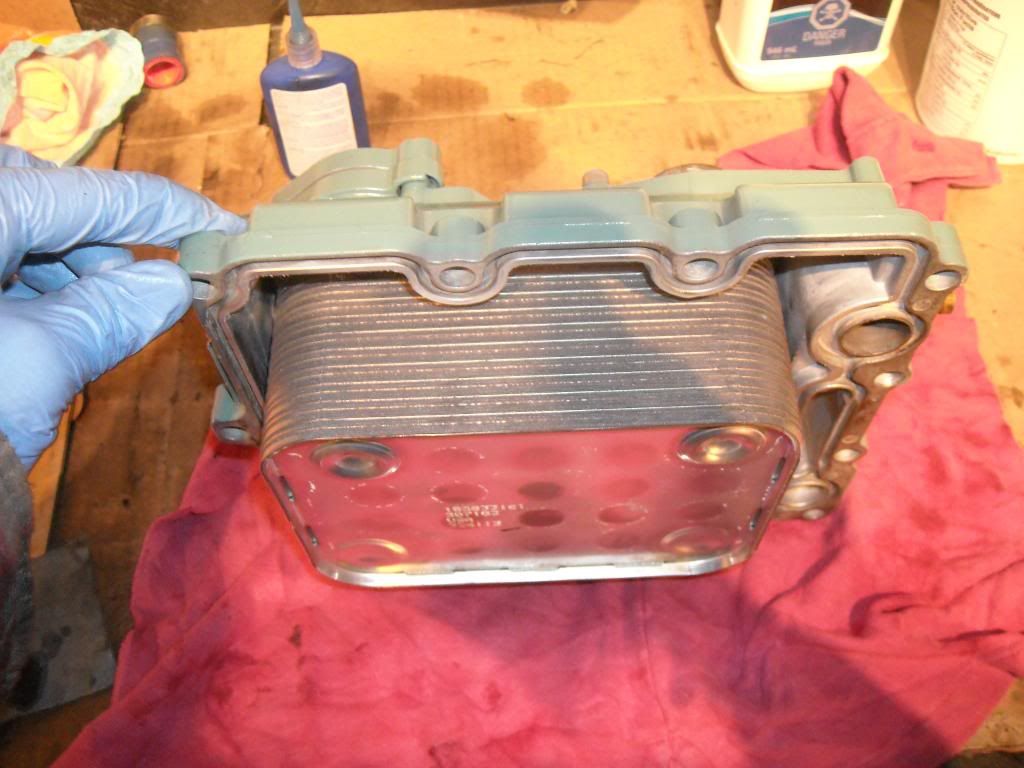

Still waiting on my heads, so I'm cleaning, inspecting and painting in the meantime.

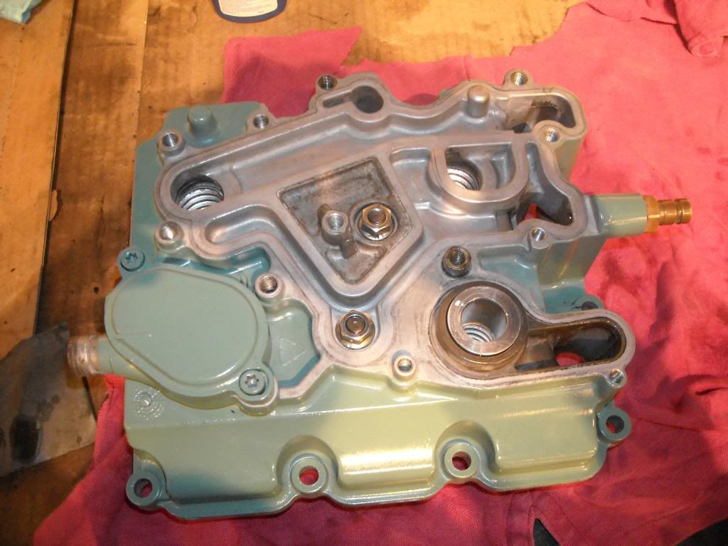

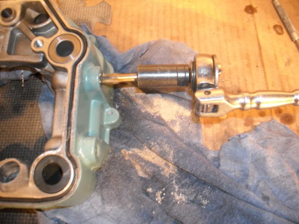

Here are a couple of pictures of my new oil cooler assembled.
Slow going, but still moving forward.

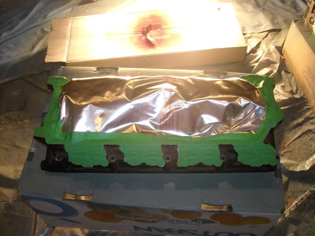

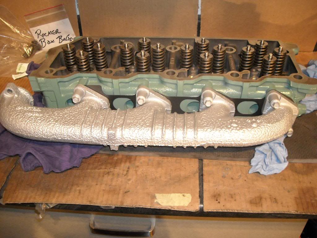

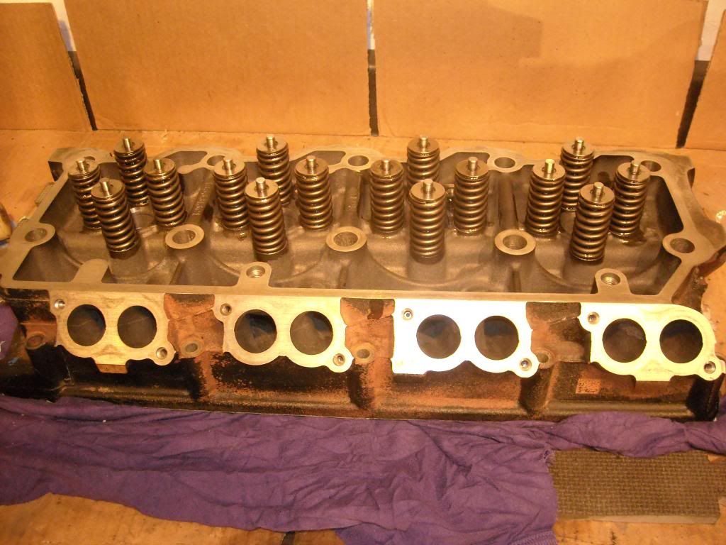

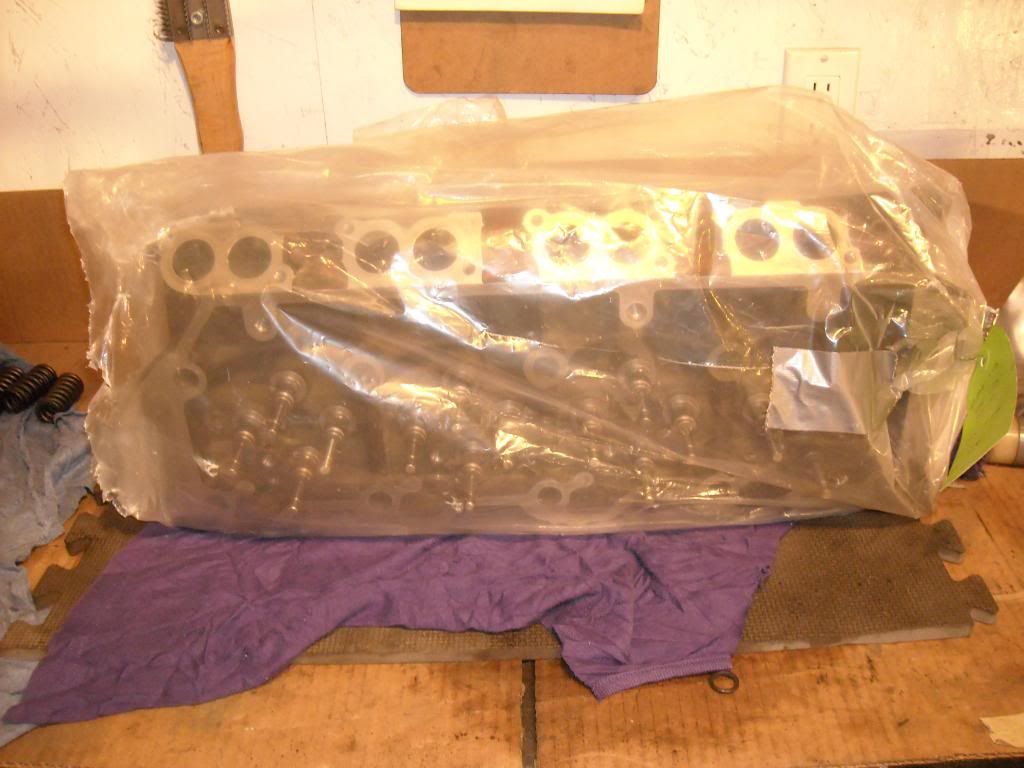

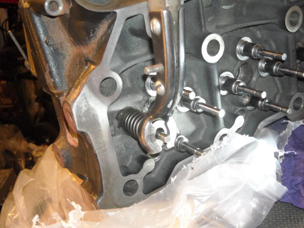

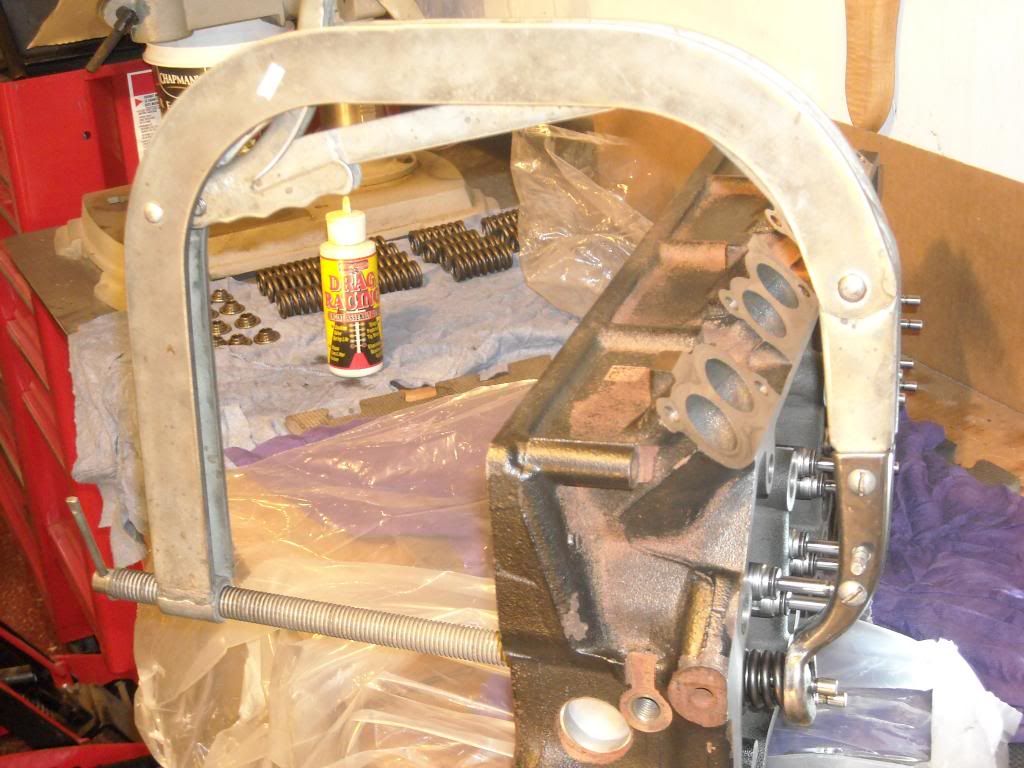

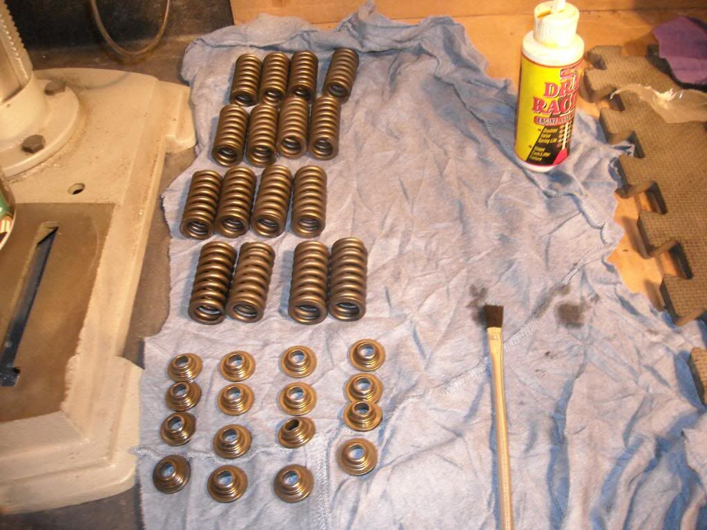

It has been a while, but I have my heads back with new guides, cleaned, machined and a few new valves.
A couple of images throwing on the springs. I used some engine assembly lube during assembly.
Head finished with all of it's valves.
head taped and ready for paint.
Tomorrow will be time to install the head.

I cleaned out the bolt hole on the rocker boxes with a tap. There was a lot of sand in the holes from when the were blasted.
Exhaust manifold installed on the head. I ordered some exhaust gaskets from Tousley Ford on recommendation from the members on the org. Thanks

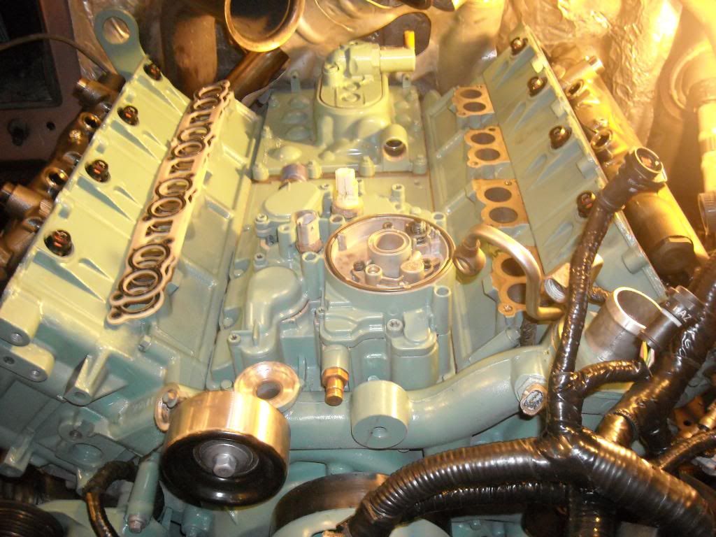

Engine ready to receive head. new OEM head gasket, started is installed, transmission fill tube in place
[url]http://i1278.photobucket.com/albums/y502/tom_power1/DSCN1107_zps6b102512.jpg[/IMG]

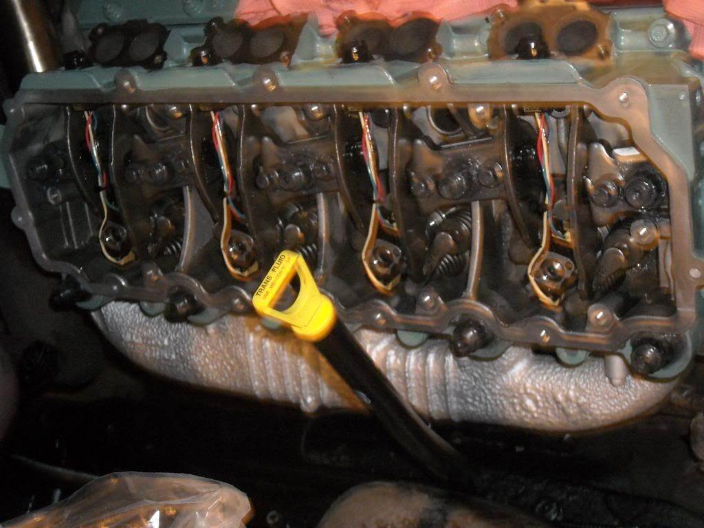

Head installed, ARP studs torqued, fulcrums, pushrods installed, and injectors in place.

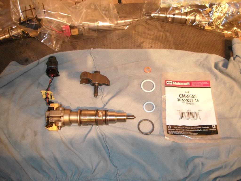

A pic of a new oring kit for the injectors.

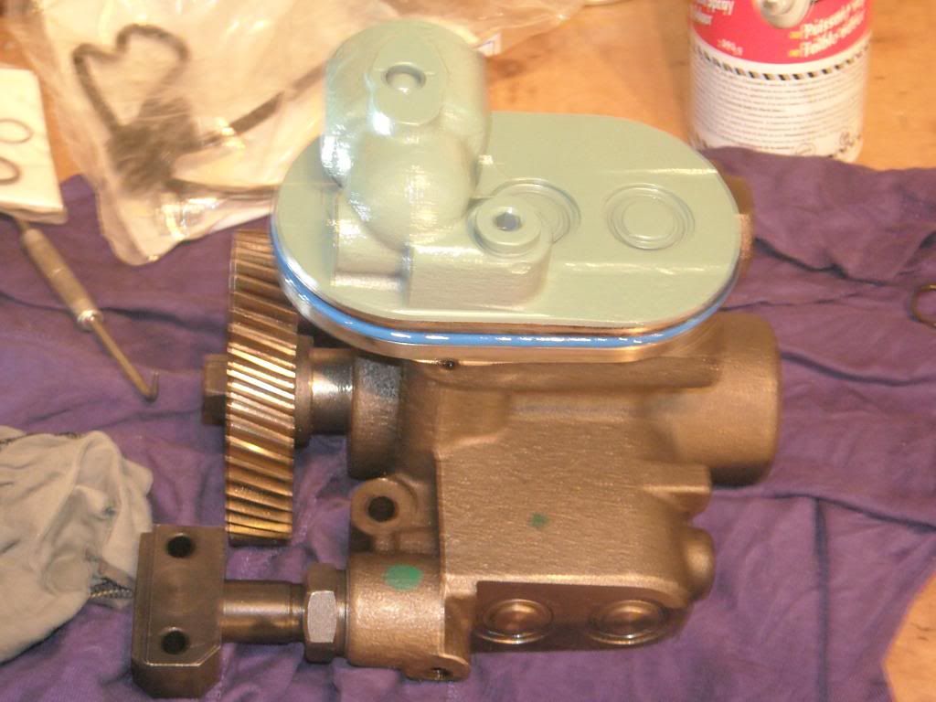

Next on the list is the HPOP. Orings removed, ready for new ones.
http://i1278.photobucket.com/albums/...psed4e98de.jpg
HPOP with new top oring and one piece SCT.
The passenger side was a lot easier than the drivers side. Before I set the drivers head in place I set in place the exhaust pipe that goes from the manifolds to the turbo. I also remover the wipers, cowlings, and a small bracket that the cowling wire bundle sat on. This allowed me a little more room for the hoist chain.
Here is a pic with the new oil cooler and IPR installed, also in place are the oil rails. The updated standpipes are sitting in the rear hole and dummy plugs in the forward hole. they were later torqued down as I needed a 12mm Allen socket to complete the operation.
I left the glow plugs out and was able to turn the engine by hand for about 3/4 of a rotation. It felt like the engine was hitting a brick. I back it up, then went forward to see if I could make it move further. It took about six tries, but I was able to get the motor the rotated. I continued to rotate for about five turns.
My question here is did I hurt a push rod by forcing the engine back and forth by hand. I'm wondering if I should have waited for the lifter to bleed down.
