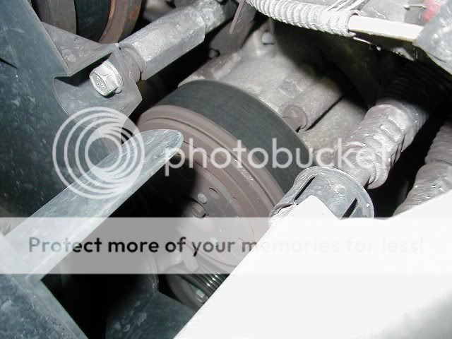

You don't have to take the alternator off. There is a catch on the idler/tensioner assembly below the alternator and all you have to do is have someone stand on passenger side of truck and grab the belt below the alternator pulley and pull on the belt while someone else reaches behind that idler/tensioner and flips that lever. Then the belt will be loose, once you get the new belt in position just get on the passenger side and pull on the belt and that catch will release and the belt will be under tension. I think I posted a picture of that catch one time and will see if I can find it.

You can see that little catch right above the AC clutch in this picture right in front of the ribbed pulley.

If you stand with your belly on the passenger side fender & look down by the pulleys, there is a stainless steel tab about one inch by half an inch, with your left hand pull the belt & with your right thumb push that tab in, it will sit in a notch holding the tentioner open.
To release just pull the belt again & the tab will pop free.

Yep, I read what he said - use 2 people - really appreciate it and the picture. Not sure I am seeing the catch or will know exactly how to flip it on the first try. It looks like it might be the piece below the AC clutch almost touching the ribbed pully. But, not sure because he said above the AC clutch. Sorry but I don't see anything above the AC clutch.
I thought using more leverage with a 1/2 breaker bar might allow for a bit more time to engage the catch. Anyway, it's good to try to understand all the options....

I believe that picture is from underneath the truck, it's the little thing in the picture between the clutch and the ribbed pulley. Also it sounds like it can be done with one person if you do it right.

Ah-ha, That helps clear things up. I will have to look as soon as I get a chance. It will probably be a while before I can get to it. But thanks for the input.
