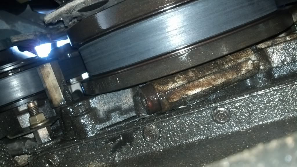

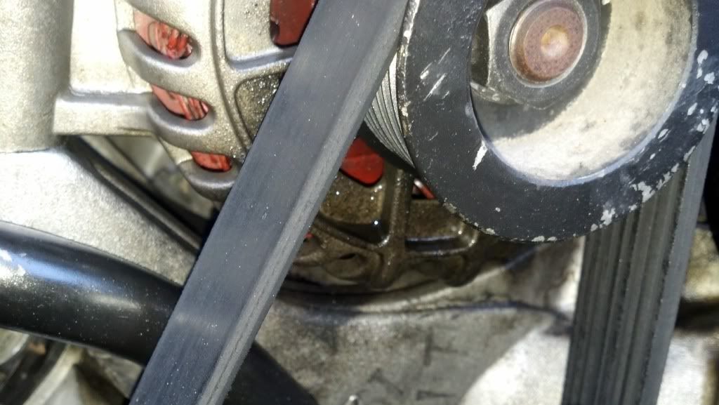

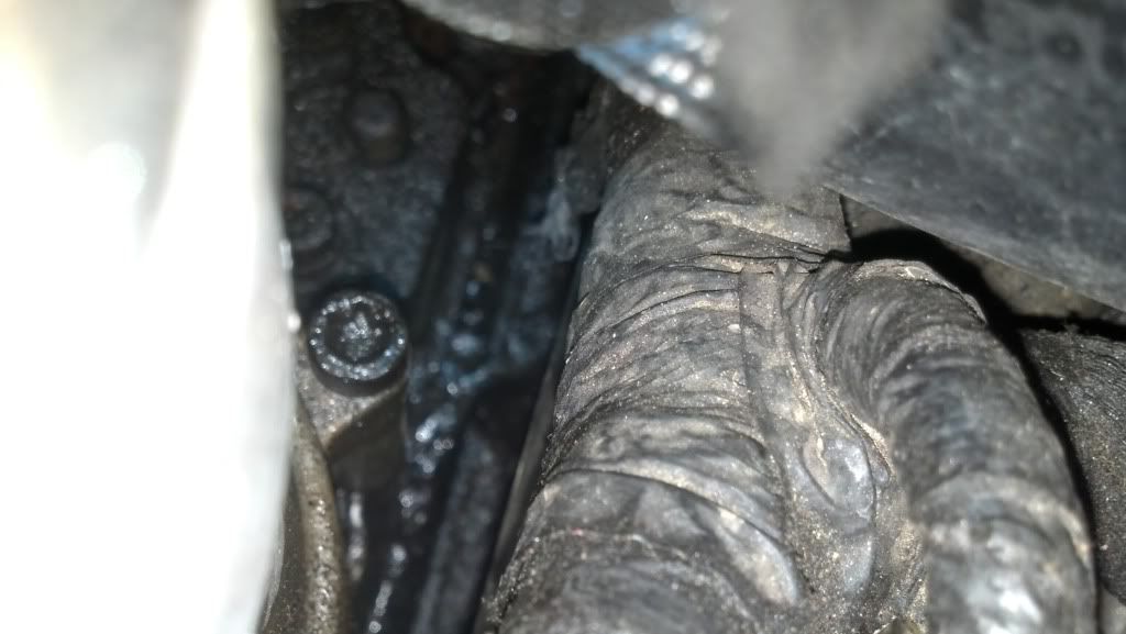

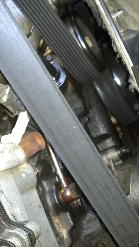

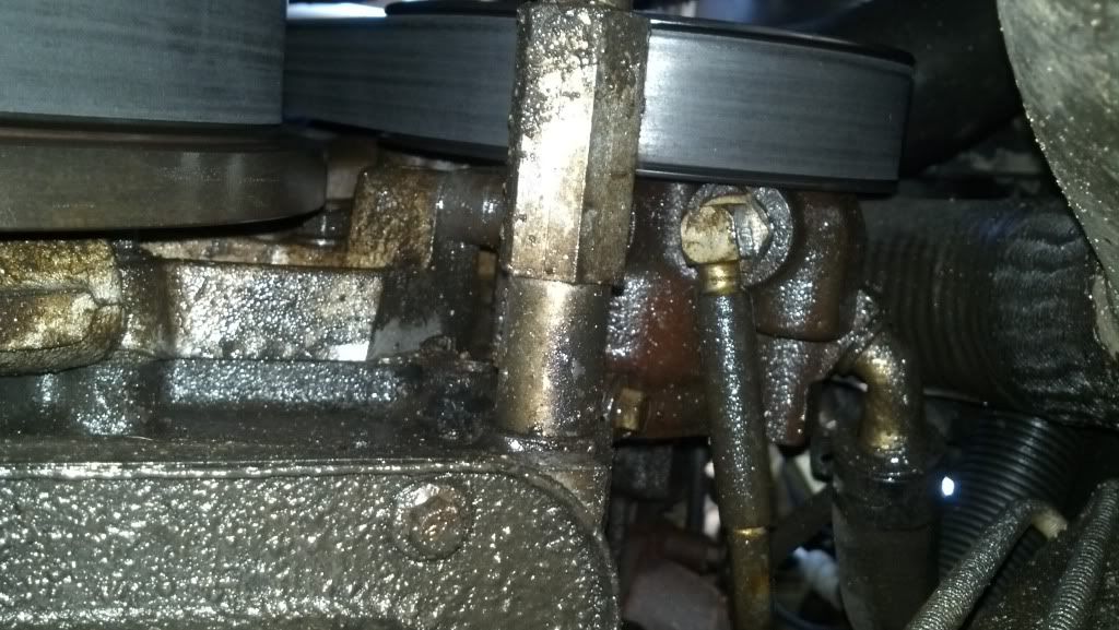

I bought this truck as my dream truck while deployed in Afghanistan. I get home a 3 years later it's all to hell. Picked up my buddy in a snowstorm the other night and had a little fun in the snow on the way home. Next morning, I look under the truck and there are about 4 different puddles
Any idea on what these leak(s) are?
There is a leak on the drivers side of the fuel bowl between the bowl and some sort of plate. Also, looks to be fuel in the valley beside the bowl.
Power steering leak on bottom of hydroboost, brakes pulse and the power steering whines while the truck is being turned(low on fluid from leak).
Power steering leak around belts. Seems to be some sort of grinding noise like a bearing is going bad. Maybe bad hose?
Here's a video of sound
Oil leak somewhere on the passenger side front of motor. Dunno where its coming from but the bottom of the hood is sprayed and the bottom of the alternator is sprayed so it leads me to believe its coming from somewhere and hitting the belts.
Lastly, there seems to be an oil leak on the back of the bell housing coming down onto the oil pan. Would this be from a bad seal on the turbo lube line?( I had the turbo off 2 years ago for the EGR delete and it's been marking its territory since with a dime sized spot)

I would start with the power steering pump. The fan belt will throw it everywhere and the fan blast will push it into the valley. It is very possible you only have one leak.

I suggest a GOOD cleaning with a de-greaser and check all the areas again. The power steering is pretty obvious source for one leak. It just may be the source of ALL the leaks.
From 20yrs of Army aviation maintenance I have found leaks from a single source in several different areas. All seemed to be different sources but in the end it was only one component requiring replacement. I'm betting the PS leaked onto the belts, then got slung ALL over the place.

First, Thank You for your service. Second, from the photo's, it looks like your fuel pressure regulator o-ring (Ford base part# 9C065)or the secondary fuel filter cap/o-ring is leaking diesel fuel. The leaking fuel will get blown all over the front of the motor from the VDF and will start leaking down the front and driver side front of the engine. It is best to repair the fuel leak and clean the engine before attempting to isolate or repair the other fluid leaks.

Do the "blue spring" upgrade. It will contain all of the parts to stop your fuel leak as the previous poster said, and will also increase the fuel pressure to save the injectors. Not expensive if you shop for it. Tousey Ford has them.
