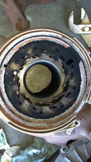

I don't think there is any thing wrong with the turbo at this point. I took it apart and everything moved freely. There was even still anti-seize from over a year any a half ago on it. I cleaned it up and have it ready to reinstall.
This is what it looked like.

That's actually really clean. Everything looks fine, I'd say the turbo isn't an issue so long as the vane control solenoid and exhaust backpressure sensor are both in good working order.
