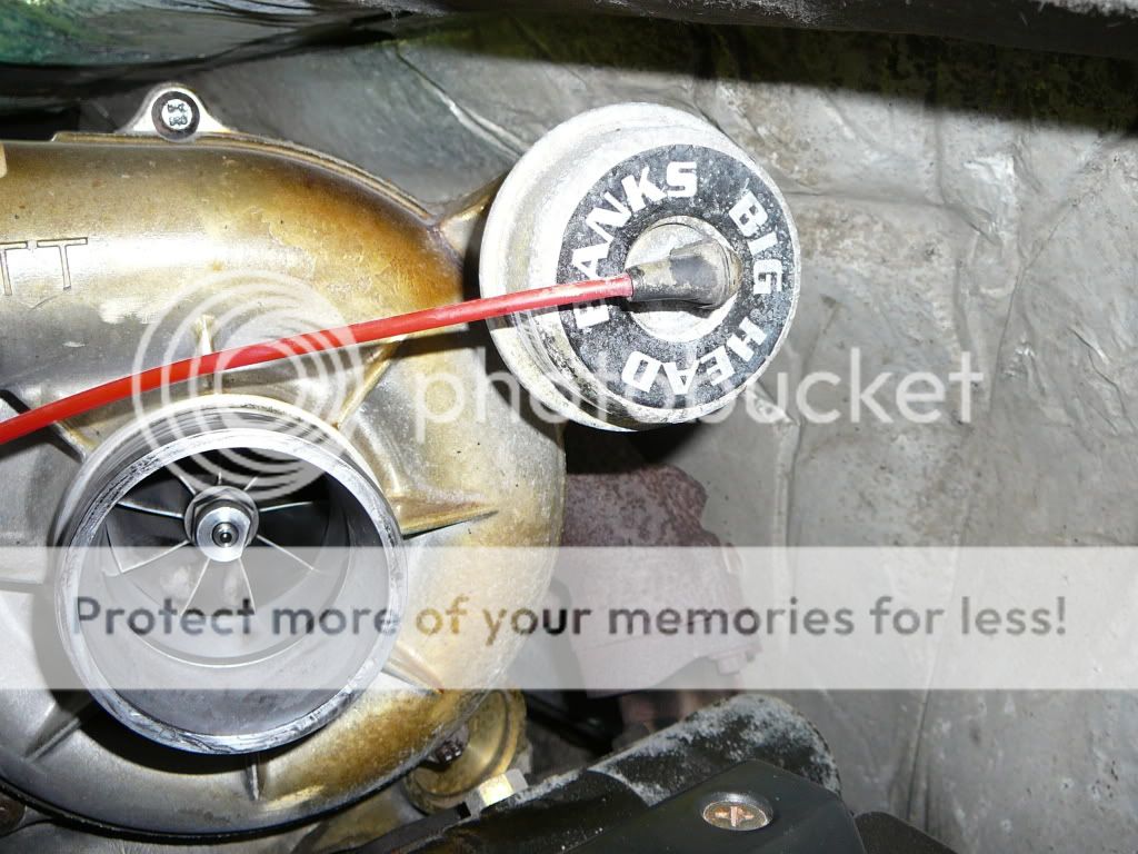

I have 2000 f350. the motor was in there lost compression on 2 cylinders. so just got another motor. other thing i did was put my
turbo on there its is banks, its has a turbo tri power chip in it.
before i always have around 30psi now cant get but 10 to 12psi.
thought it was the chip so i took it out,still same thing 10to 12 psi.

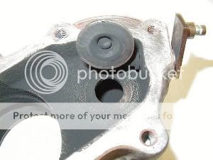

The wastegate actuator is attached to the compressor housing, it goes across the top of the turbo to a lever that opens the wastegate in the turbine housing. The actuator should be set where there is a little tension to hold the wastegate closed. When you are on the throttle hard the WG solenoid should allow some of the manifold pressure to be ported to the WG actuator to open the WG. This keeps the turbo from prematurely failing when you are asking for lots of boost, then let off the go pedal.

Thanks woodnthings8. i have the same one in the picture. i took the turbo off and check everything the gate was opening good without the big head on .put everything back together still no boost. what else
