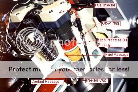

well i think im going to do all 8 injectors and the vc and wiring under the vc. i hate to spend the money but for it to have this many miles i think i will be money ahead if i go ahead and do it and that will take care of the thot of my injectors being bad. o plus new glow plugs.
i havent heard of the injector cup but sounds like i will go ahead and buy that to so everything under the vc will be good to go i hope.

The injector cup is installed into the head as a "press fit". The injectors seat into this cup and it separates the coolant from the fuel. This allows the coolant to flow around the injector and cool it quicker. They are made pretty soft, so they expand and contract as the engine heats up and cools down. This causes the material to work harden and eventually crack. They can be removed from the heads with a special tool. This can all be done with the engine in the truck. Pretty straight forward project, just allow yourself a couple of days to do it. Most can do it in a day, but if you are doing everything under the VC's, you might as well take your time and not rush it.
Stick with OEM Glow Plugs as there are others out there, but not as good. The Motorcraft ones are not really much more expensive than anything else. The ZD-11's are fairly cheap (Under $10) at this store K-Mans Parts
Replacing the UVCH is also a good insurance, as they can also go bad on you. The VC Gasket does not need to be replaced as they are reusable, but if you have some extra cash go ahead and replace them if you choose.

great pic and thanks again when i git the all the work done ill let everyone know if it fixed my problem im preaty sure it will at least i hope so.... if i run into any problems ill besure and git back on thanks for all the help.
