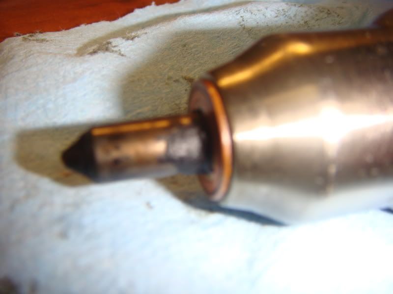

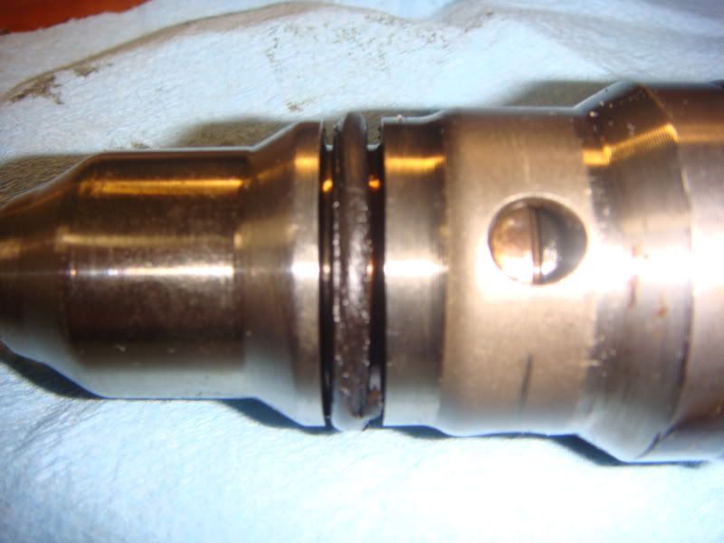

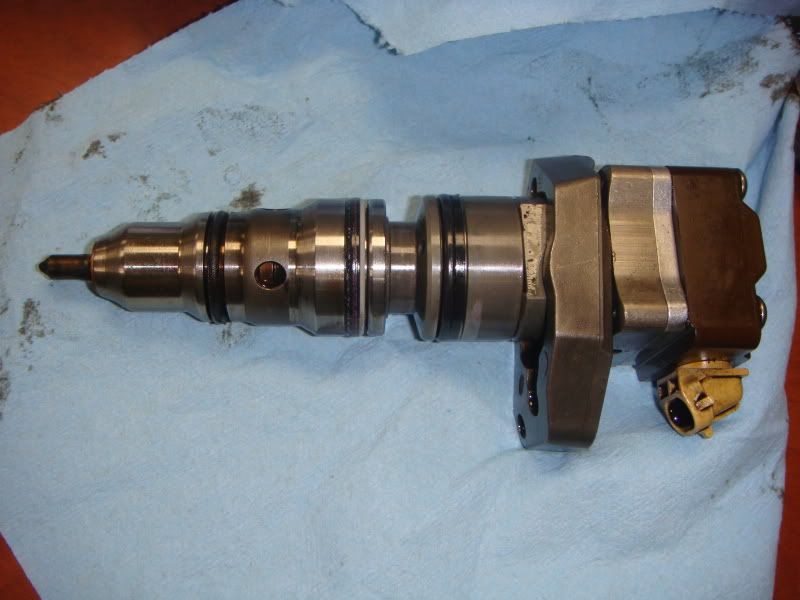

Attached bellow are pictures. For starters, since the truck wasnít hydrolocked anymore because I turned it over by hand, I was unable to find out which cylinder had fluid in it by pulling the glow plug. I ended up pulling all the glow plugs and then all of the injectors. Looking at the injectors, the o-rings were all getting old and though they may not have been leaking, they appeared to be on their last leg. I took a picture of the one that was leaking and posted it below.

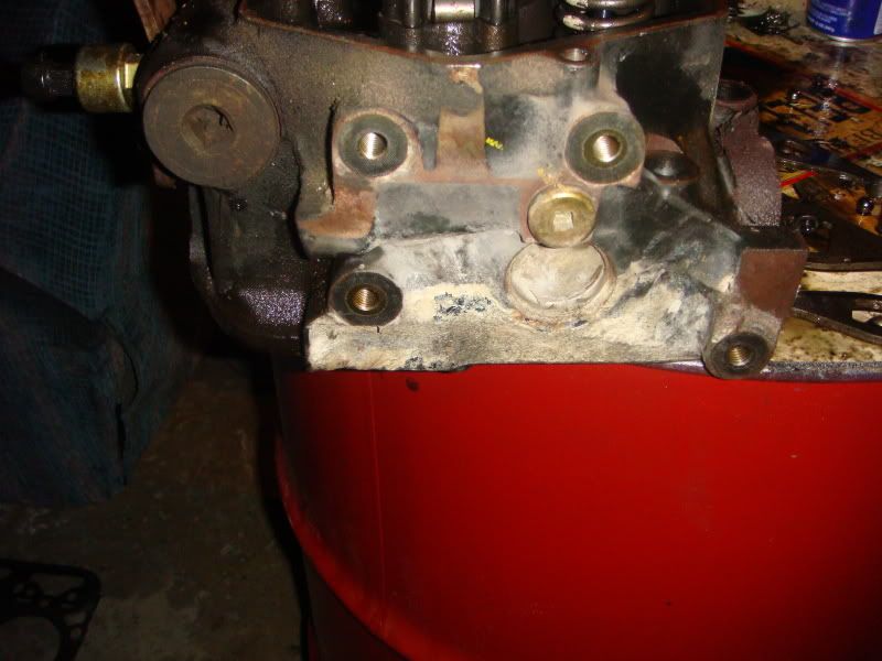

After taking the injectors out, upon further investigation, I noticed there was a white build up on the front driver side head. I took a picture of this as well. I thought this was an indicator of a blown head gasket, so I pulled the head off. Apparently the water pump has been leaking and caused this because the gasket was in good shape.
Tonight if I can work on it, I plan to check the stroke of the hydrolocked piston compared to the stroke of the others to insure that I did not bend the connecting rod.
What I need to know is:
Since I have all the injectors pulled, should I have them tested? Truck has 180,000 miles on it
What should I replace on the injectors? Bottom o-rings obviously, copper washer?, other o-rings?
Should I clean the injectors?
What would be a good manual/book to buy that would give me the torque specs on this motor?
Thanks for your help.
1. Since I have all the injectors pulled, should I have them tested? Truck has 180,000 miles on it
2. What should I replace on the injectors? Bottom o-rings obviously, copper washer?, other o-rings?
3. Should I clean the injectors?
4. What would be a good manual/book to buy that would give me the torque specs on this motor?
1. I think you should - one of them is likely the source of your hydrolock. The o-rings wouldn't cause that, it would have to be a leaking injector if fuel was the cause of the hydrolock. Make sure and check your injector cups. Also, use a feeler gauge and check the poppet clearance - here's how: http://www.dieselpro.ca/Poppet%20Valve.pdf
2. Replace everything - it comes in the kit. Make sure the old copper washer comes out with every injector. You can get the kits here: Replacement O-rings for Ford Diesel Engines
3. Proper cleaning requires dissasembly - a little too technical for most. If they fail the bench tests, best to just replace them.
4. AllData is an online service manual - it costs about 26 bucks for the first vehicle and 16 for each additional. It has step by step instructions along with specifications, part numbers, and more. https://www.alldatadiy.com/
