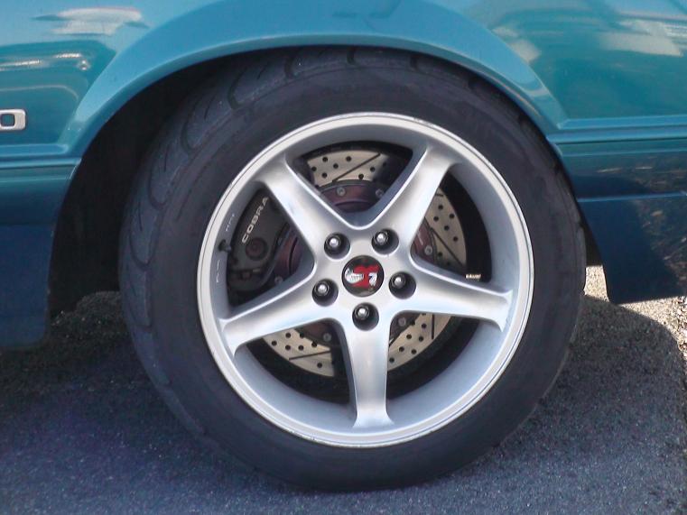

Now, for some gratuitous brake porn.

That rotor reminds me of the blades that go into one of those late night infomercial food gadgets. You know, "it slices, dices, cubes, shreds, makes shoestring potatoes with ease, all for $19.99, and if you order right now, ...."
I don't imagine that one costs $19.99, with a second one free- all you have to do is pay S&H.
