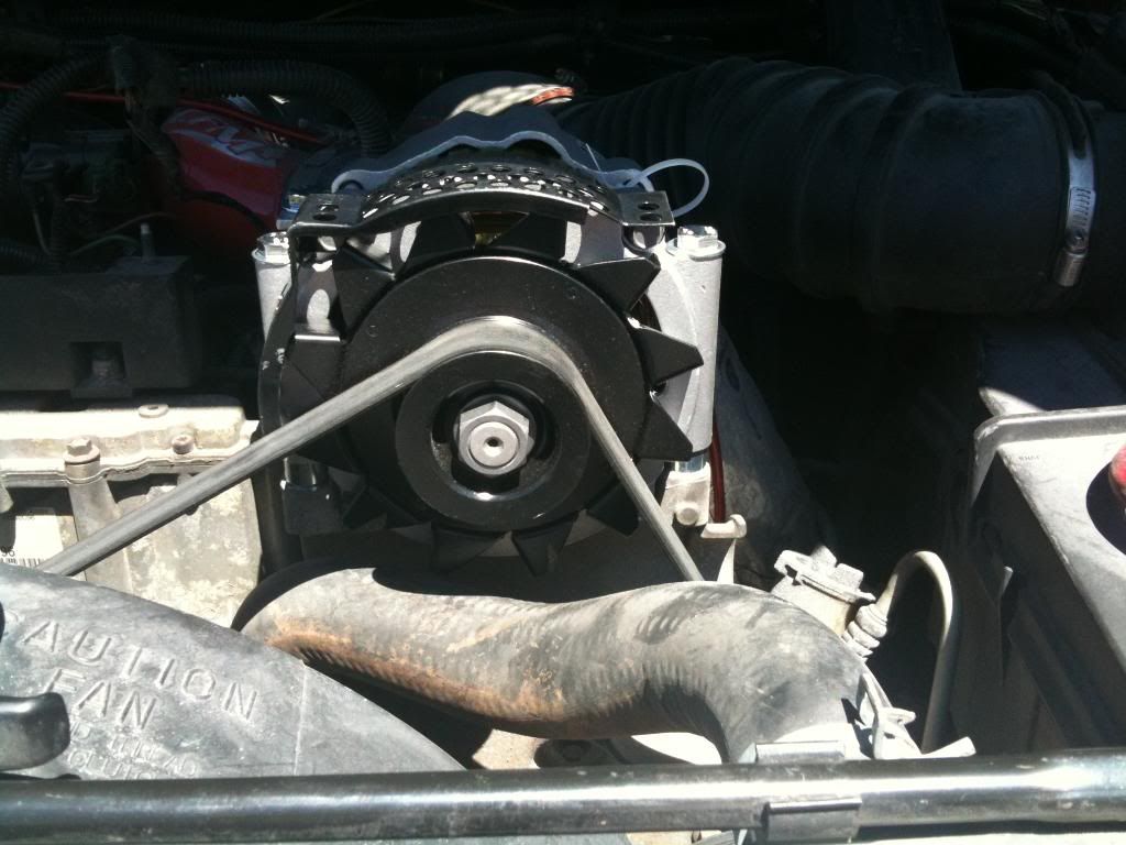

Has anyone done this swap? I am going to attempt to swap out my stock alternator for the high amp ambulance alternator that is quite a bit larger.
it appears so far that i will need to modify the bracket for more space but it seems it will bolt up.
any help or experiences would be greatly appriciated!

I purchased a 215 amp alternator from autozone last night for a 2000 e-350 with the ambulance package. It is HUGE!
I believe it will fit the mount holes, but the bracket will definatly need modification. I will attempt to post pics soon after I get it mounted and
hopefully it works...

well it is mounted, hooked up and works great. I needed to cut and modify the mounting bracket and space it up so it would not hit the upper radiator hose. here are some pics
size comparison
mounted
note the spacers used.

You could have replaced the upper radiator hose with one meant for dual alternator application. Would have routed it out of your way. No spacers needed. Plus if your belt were to break you wouldn't have to R&R the upper radiator hose to replace it. Just a thought.

Did you have to get a different belt because of the larger size of the alternator?
And Diablo is right. When I changed out the water pump, I went ahead and put on the upper radiator hose for dual alternators to reroute the hose out of the middle of the belt. Well worth doing, imo.

So what was the reason for going to such a big alternator?? I can see up grading to a bigger one like the DB...But wow that beast is huge!!! When my aftermarket fog lights are on and ac cranking the idle drops a fraction and the headlights dim ever so little. But I feel ok with my alternator. I keep looking at the pic it looks nice.

My truck has factory dual 110 amp alternators. They are small case 6g alternators. I'm not aware of a smaller cased alternator. I have the new parts to build a couple of large case 6g 135 amp units for my truck. I may have that project finished in a couple of weeks.
The alternator in that picture is not the OE Y2k unit.
