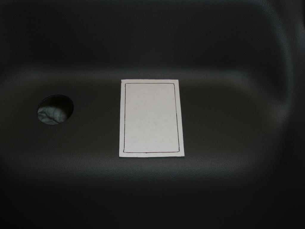

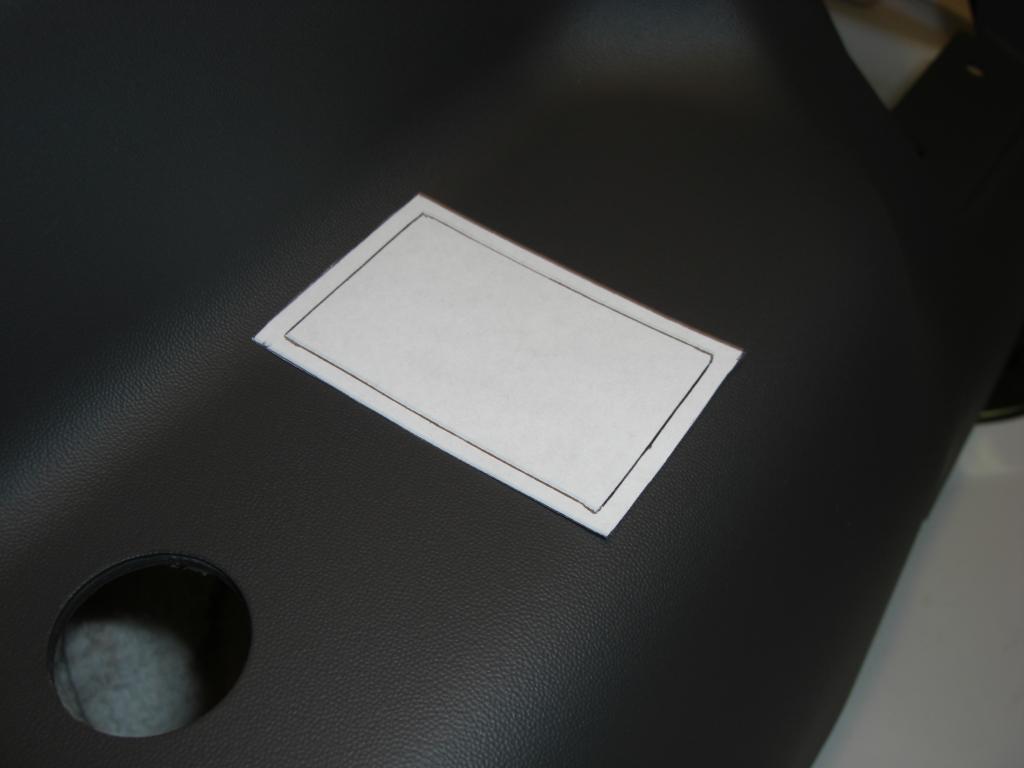

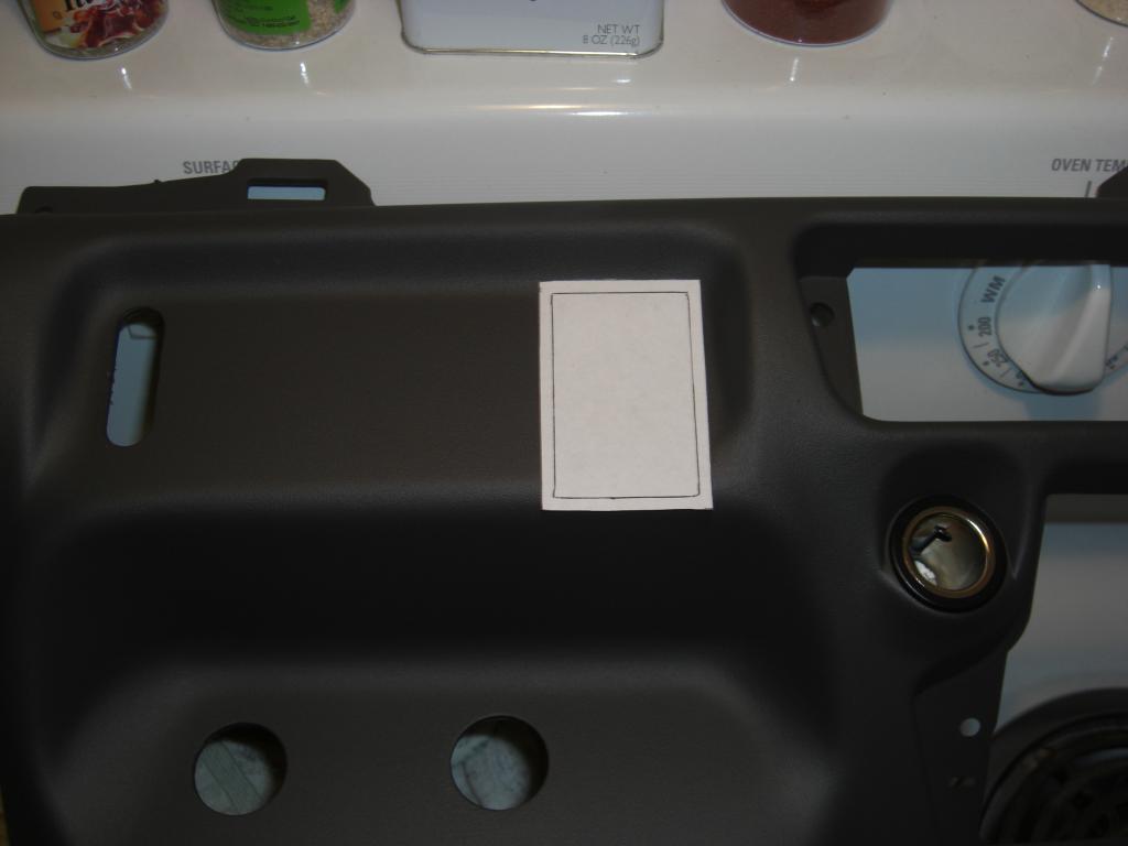

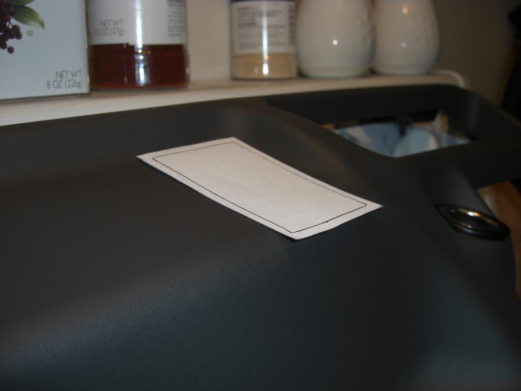

Ok, so a few weeks ago I got the measurements for the JMS mount from Jody @ DP Tuner and made a template to use for mock up. The size of the template is the exact dimensions of the face of the JMS mount, with the black line on the template being the dimensions of what the hole would need to be based on the lip/overhang of the mount.
Today my F650 manual lower dash panel came in, so I was able to determine that there just isn't enough room on the top section. You would either have to cut into the curved edge at the top, or have the mount overhanging on the bottom where the dash steps down to the lower section. Would be hard to do without it looking like a hack job.
Now, it does look like there's just enough room on the bottom section for it to sit flat and flush. The only thing I'm concerned about is location height on the bottom section. I'm going to wait until I get the lower dash panel installed in the truck and get a feel for whether the bottom section of the panel is too low to have the switch mounted, or an ok/acceptable height. Just don't want it so low that it's hard to see, a stretch to reach, or worry about the buttons being easily hit with legs or knees.
