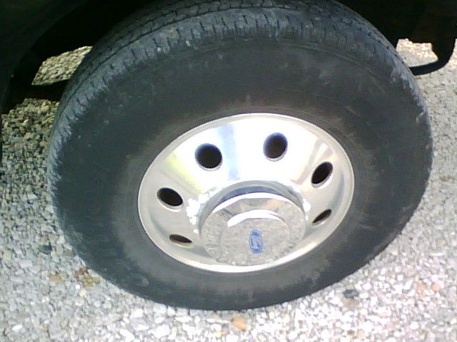

Hate to drag up an old post but my 96 has started corroding on the front wheels as well.
Very seldom driven on salted roads.
I'm thinking the new truck wash I have started using is causing this.
This is an automated touchless wash big enough for duallys.
It has a wheel cleaner option and I think it must be pretty corrosive.
The fluid is getting trapped behind the center caps I'm thinking.
Here are a couple cell phone pics of my wheels.
Gary

Hi Gary,
Yes, that is what my wheels look like only mine are much worse. My rear wheels are starting to do the same thing. I still haven't done anything with them yet.

The aluminum inserts in the running boards on my King Ranch did the same thing, here in the NorthWest the anti-ice products (fluid not salt) they put on the roads tend to attack aluminum, while my wheels still look good, the inserts on the running boards will need to be replaced, I've never had good luck trying to polish diamond plating.
Funny thing is mine didn't show up until spring.
tly is offline
post #12 of 19 (permalink) Old 11-24-2009, 09:26 PM
Join Date: Sep 2009
Location: FL/VA-where ever I go
Posts: 246
The fluid used in place of salt is probably calicum choride which is used by a lot of states now. highly corrisve and must be washed off immediately after driving in it. Espesially the undercarriage.
