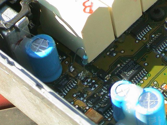

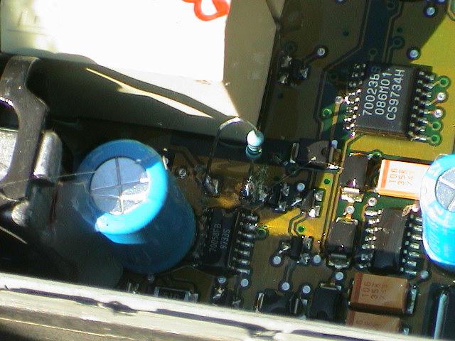

Well I'm ready to solder the new resistor, but i want to make sure. 1995 F-350 auto 4x4, now no question on application, ohh wait its a crewcab. No just kiddin, seriously, where the harness plugs into the IDM box, there is a sticker that says 100A is that the 75.0 k ohm resistor, also I know the picture of the IDM on the forgotten is a 99 SD but is there only 1 resistor in this box or more. Also, does the resistor (stock) read 4.7 or sumthin or other. I got a real expensive resistor, it was 65 cents, thats the proper one right, right. Im ready with my buddy that builds and services ATMs, he is the one with steady hands. He

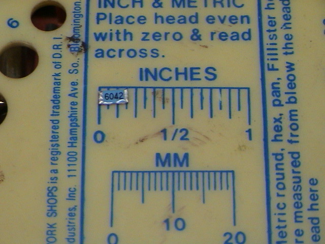

here is a picture of what the one you take off should look like
unless you have the model with the 1 WATT resistor... this is the 1/4 watt version
The one you remove should look like this
Not sure what type of resistor you purchased to put back in, I used a metal film 1/4 watt, 1% tolerance 75K ohm, axial lead resistor, here are pics of the install on it...
IDM MOD 1
IDM MOD 2
its also advisable if you use the axial lead resistor to rtv or epoxy it to the adjacent capacitor to decrease the chance of solder fracture due to vibration
you should refer to the other thread about the differences we noticed on the different IDM's apparently there are at least 2 different versions...
