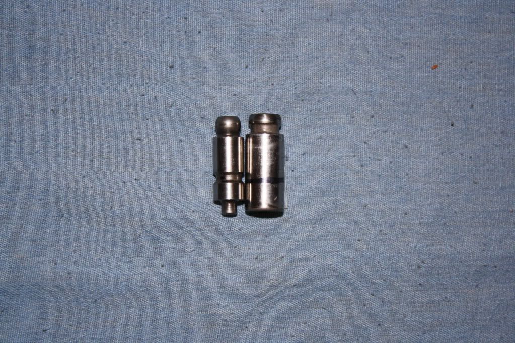

post #58 of 58 (permalink) Old 12-01-2012, 11:21 PM
NMB2's Avatar
Join Date: Sep 2011
Posts: 168
Originally Posted by Evel486 View Post
The misinformation out there is the main reason I ever got onto this site. I got curious as to why some people came into my shop for a repair and then proceeded to tell me I was doing it wrong because they "saw it on the internet"
I'm sorry we had a miscommunication- I'm a wrench puller. Sometimes I don't get my thoughts across well on this keyboard.
Your pump ideas sound interesting. Have you thought of dropping the light load advance altogether? Then you could run a much stronger DM style advance piston and cam pin.
My light load is functional, my speed advance is not. This was the side effect of the modifications. Still very streetable, almost not noticable.
Here you can see the difference in size between the stock DB2 pin and the pin we run.
This was pre-machining of the groove in the new pin... but you get the idea:
We EDM the stock advance piston and cam ring, and lap them together to accept this new, larger pin. We also modify the servo piston.
