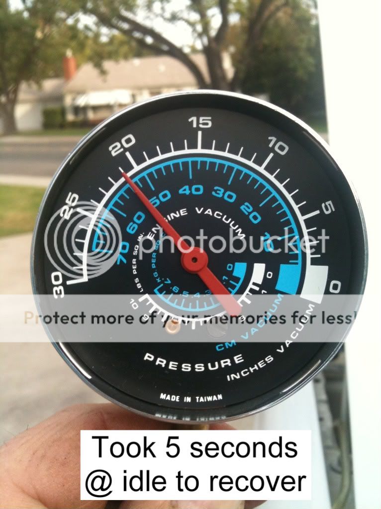

Vacum gauge hooked up at TREE
All readings are @ idle speed ( 650 RPM) First one is reading BEFORE brakes applied. Second is just after brakes applied. took 5 seconds to recover @ idle speed.

So this means that the A4 testing guide is incorrect?: TheDieselStop.Com Photo Hosting - Vacuum test Part 2
It should of said "maximum drop should to be no less then 21hg inches" right? Or do they mean that a decrees from 23 should be no less then 3hg inch? example: 23-3 = 20
Thank you for the pictures. Very kind of you to post that. Is your results when you did the test A4?
I didn't follow any "test" procedure. I warmed the truck up so that it idled at 650. Took a cap off the tree and hooked the gauge up. Stood by the drivers door and took a pic with the truck idleing in park. Then I pressed the brake once and took a picture as I let the brake off. Then counted seconds until it read the same in the first picture. I NEVER touched the go pedal.
