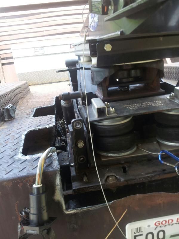

If you are serious about towing, especially a big 5th wheel, then you need to go to an Air Ride Hitch. Air Safe - Air Hitch Technology Once you get one you won't believe the difference. I have had one for 4 years and its the best thing since sliced bread. Granted they are more expensive but it eliminates the shock load to your truck and trailer and give you a smooth ride. Air Safe Hitches are not the only ones out there. Trailair Trailair make a good one as well.

Too late for the OP back in 2010 but for anyone looking now, I think this is one of the best on the market and better yet, the resale is excellent. I have owned and used about five different hitches over the years, including Reese, B&W companion, Valley, Draw Tight and Colibert goose neck. Here is the one I own now and will never go back to the others. Air Ride Fifth Wheel Trailer Hitches for Reese Rails...

I have that hitch and man its the best. Ride is so much better and stuff does not move in the camper while running. Left a bottle of water on the table running across I-40 From Exit 126 to Cookville. And it was still sitting there when we stopped for lunch.
