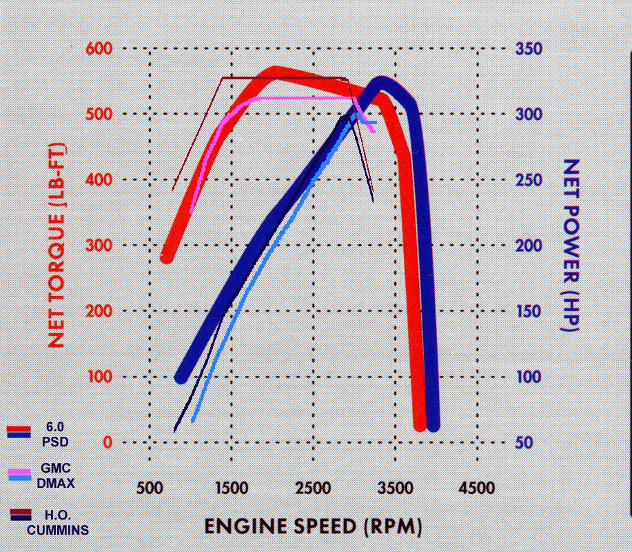

Have you seen the torque curve on the 6.0? Granted I haven't seen the stock curve but I got to compare my wife's 03 6.0 to my 2000 7.3 and the 6.0 had a far better torque curve than my 7.3. It made more torque at a lower rpm and held it longer than the 7.3. I'm not sure if J&D performance still has those dyno runs saved or not but the next time I venture up their way I will ask for a copy and post it. Now the 6.0 is only what 3 years old so the jury is still out on how long it will last. I guess if it don't I can always fall back on my 6.9! [img]/ubbthreads/images/graemlins/eek.gif[/img] [img]/ubbthreads/images/graemlins/biggrin.gif[/img]
Super,
Here was the stock torque and hp curves as they stood in 03 for the 6.0, Cummins and D-Max.

Thanks! [img]/ubbthreads/images/graemlins/cool.gif[/img]
