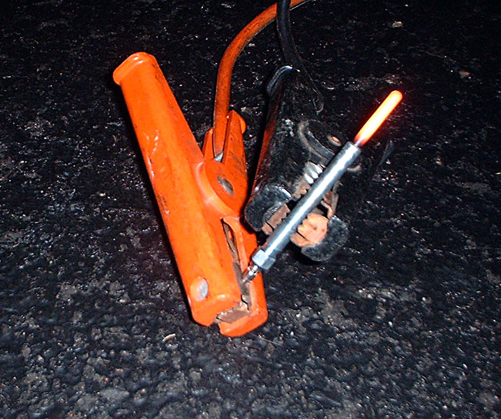

I know GM (pre-Duramax) diesels had a problem with swelling glowplugs, which would then break off tips when you tried to remove them, but I hadn't heard of any doing that from staying on too long. I can't imagine what could get worse than being on a couple of minutes already, and withstanding combustion temps and pressures all their lives!
Just in case you ever wondered what a glow plug looks like when on, here's a new one before I put it in my '97:
http://www.backglass.org/duncan/lit_glowplug.jpg
