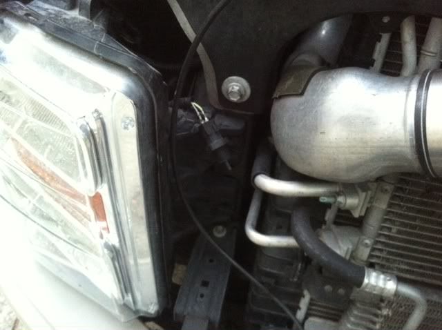

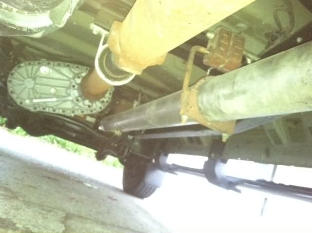

Thanks for the info everyone. Here are some pics of the exhaust and a misc plug up by the passenger side headlight that I couldnt figure out what it was? Does anyone recognize the plug or the exhaust for that matter? Is this the factory downpipe?

that item by the headlight is a sensor for your temp I'd say...nothing to do with the exhaust system at all.
Pics look like no cat or dpf.
Personally I'd take it back like a couple have advised. Simply because later on down the road if you sell it they may not take it on trade...or if you have warranty work needed or emissions testing comes into play.
Just have them give you the straigt pipe so you can put it back on later when you get a tuner.
