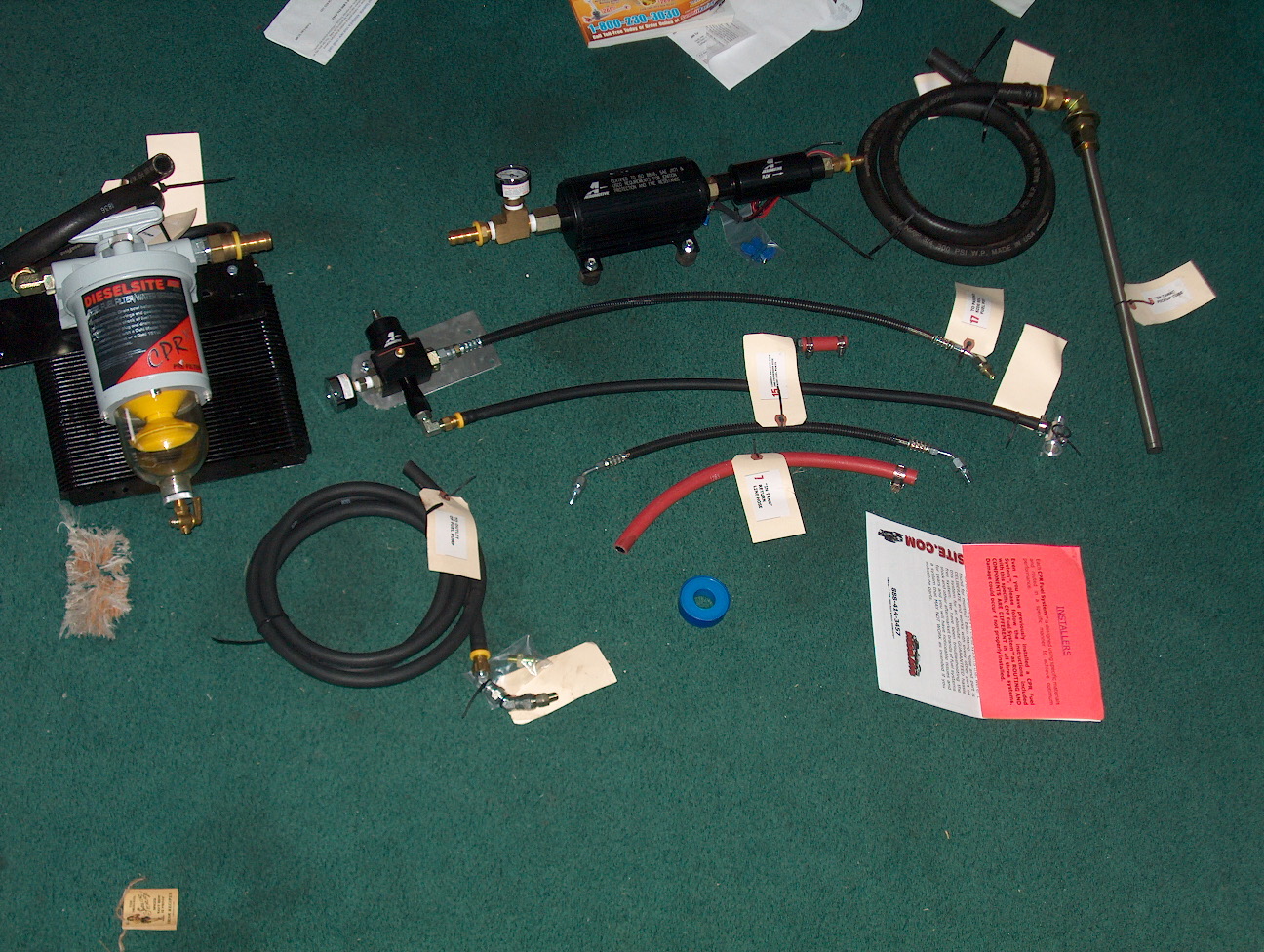

Got my CPR+ fuel system . . .mmm beefy.
Got it last week. Don't even ask when I'll get the time to install it.
The picture below is exactly what you get and how it is shipped.
I tried taking individual pictures, but I can't use the flash or it washes everything out, and not using the flash makes the exposure too long and I get blurry pictures.
I can try again with the flash if people want some pictures of something specific.
What you get that you don't know you'll get--a high pressure crossover line.
You will need a/c disconnect tools for the fuel lines (not included).
The pump/filter ship assembled and ready to go, so does the DAHL 150 and return fuel cooler.
All the hoses, if they screw on, are finger tight, if they need to be clamped, they're clamped tight and ready to be installed.

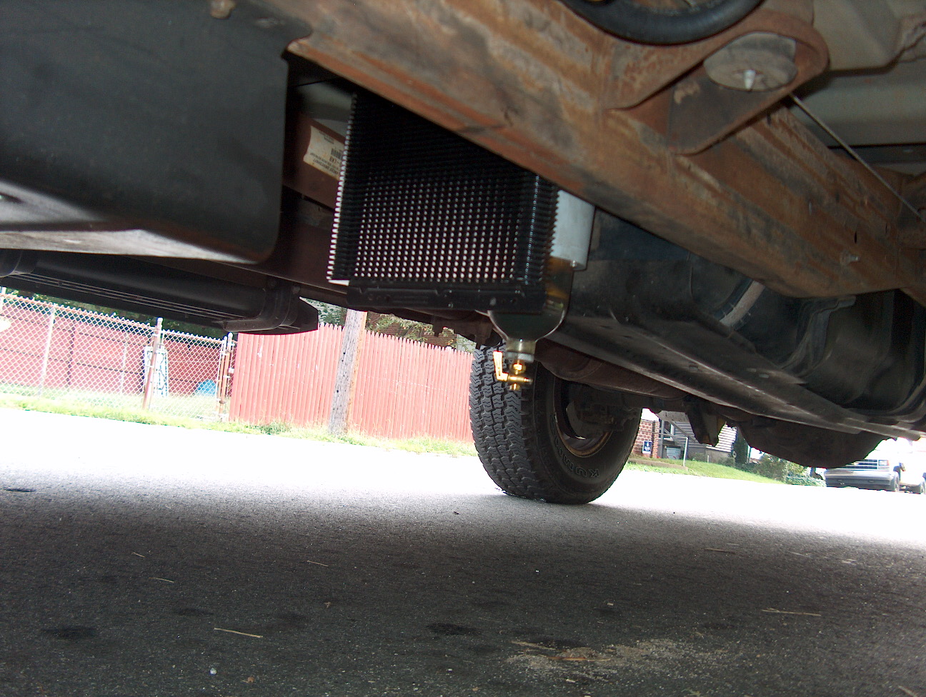

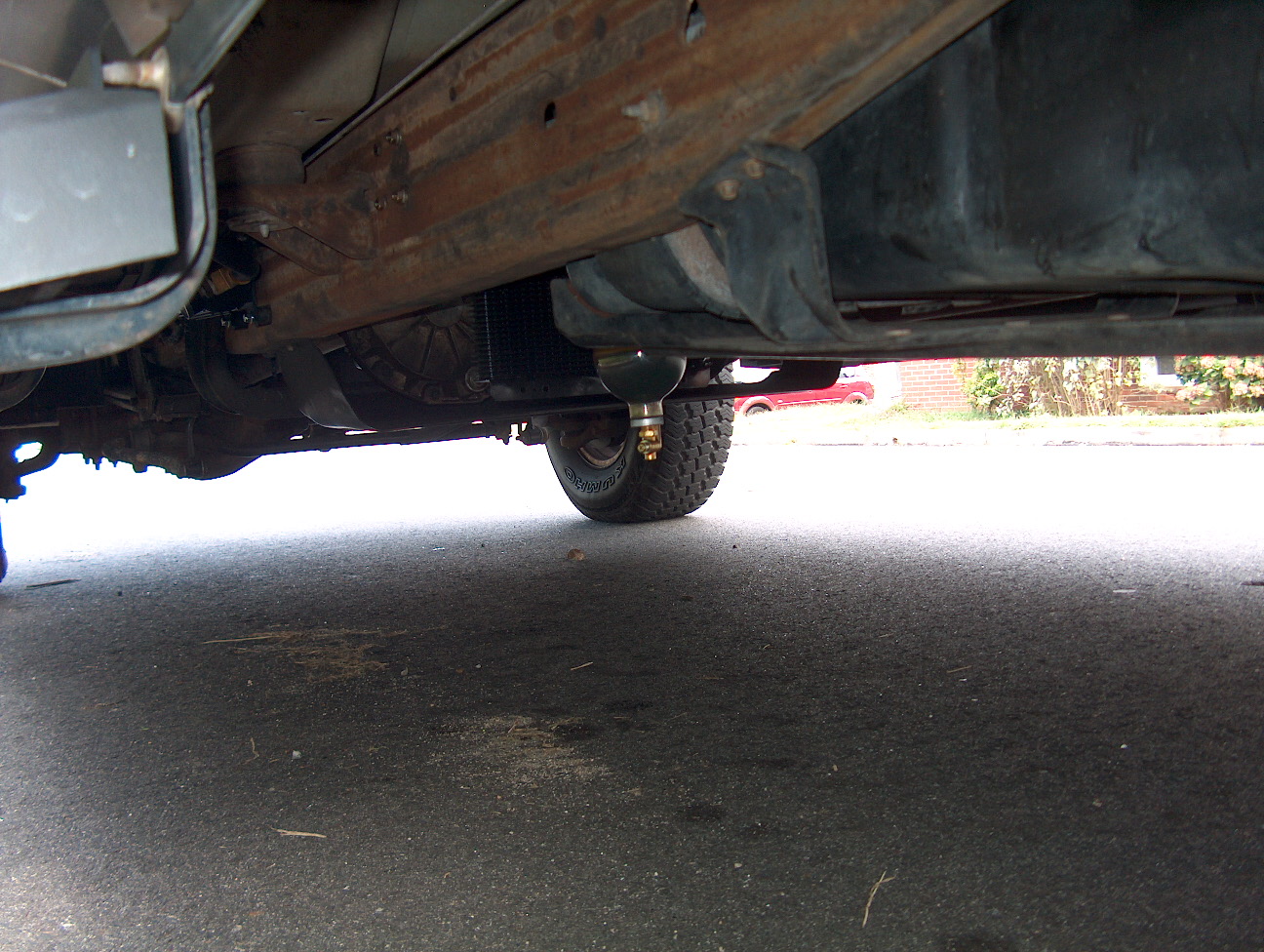

Halfway installed as of this afternoon. My mechanic was pretty impressed with the parts I provided and the kit as a whole.
Seperator/cooler are on, fuel tank is done. Guy is taking a little longer than I would like.

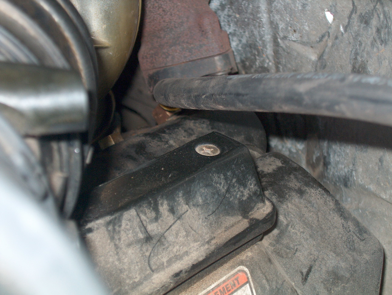

That cooler/seperator really hang down low. It is maybe an inch higher than the bottom of the tank.
I may have to come up with a skidplate of some kind just for my piece of mind.

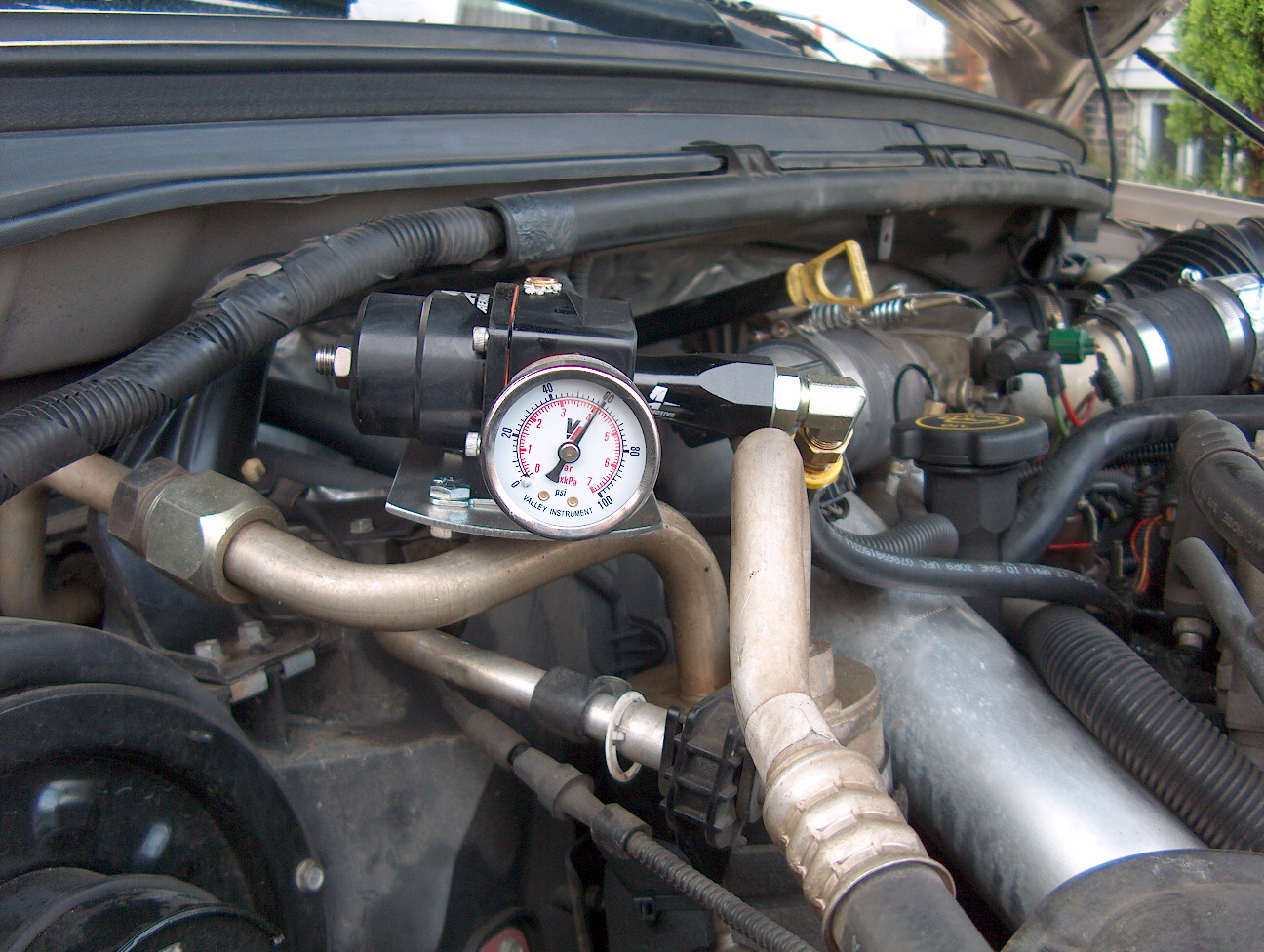

Initial observations--not very difficult to get to over 3,000rpms. It shoots right up.
Idle is different. Not sure how to describe it, it sounds maybe a bit choppy? I can feel a pulsing in the brake pedal. If I hold the supply fuel line or the regulator supply line, I can feel the pulsing in it in tune with the engine.

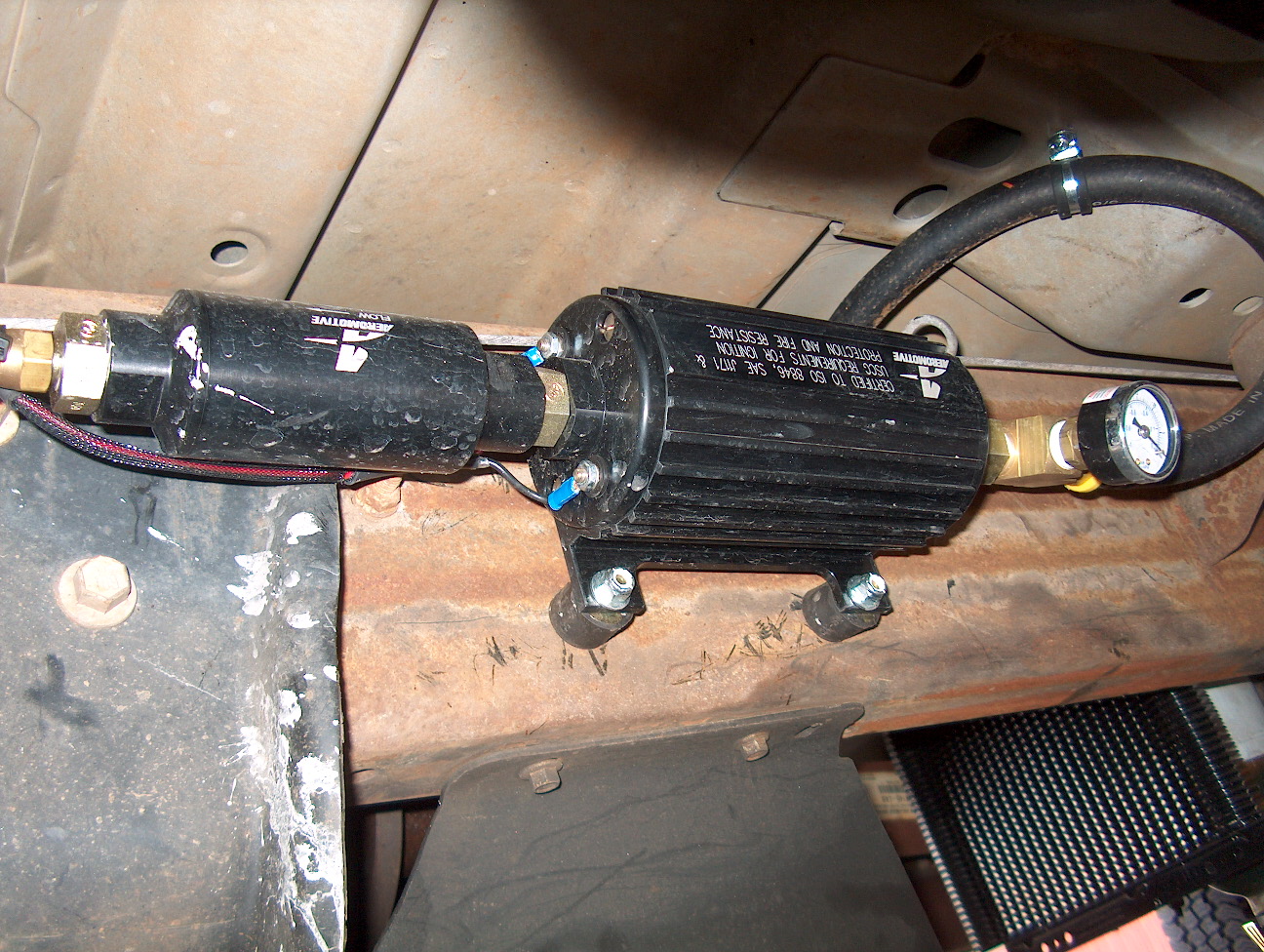

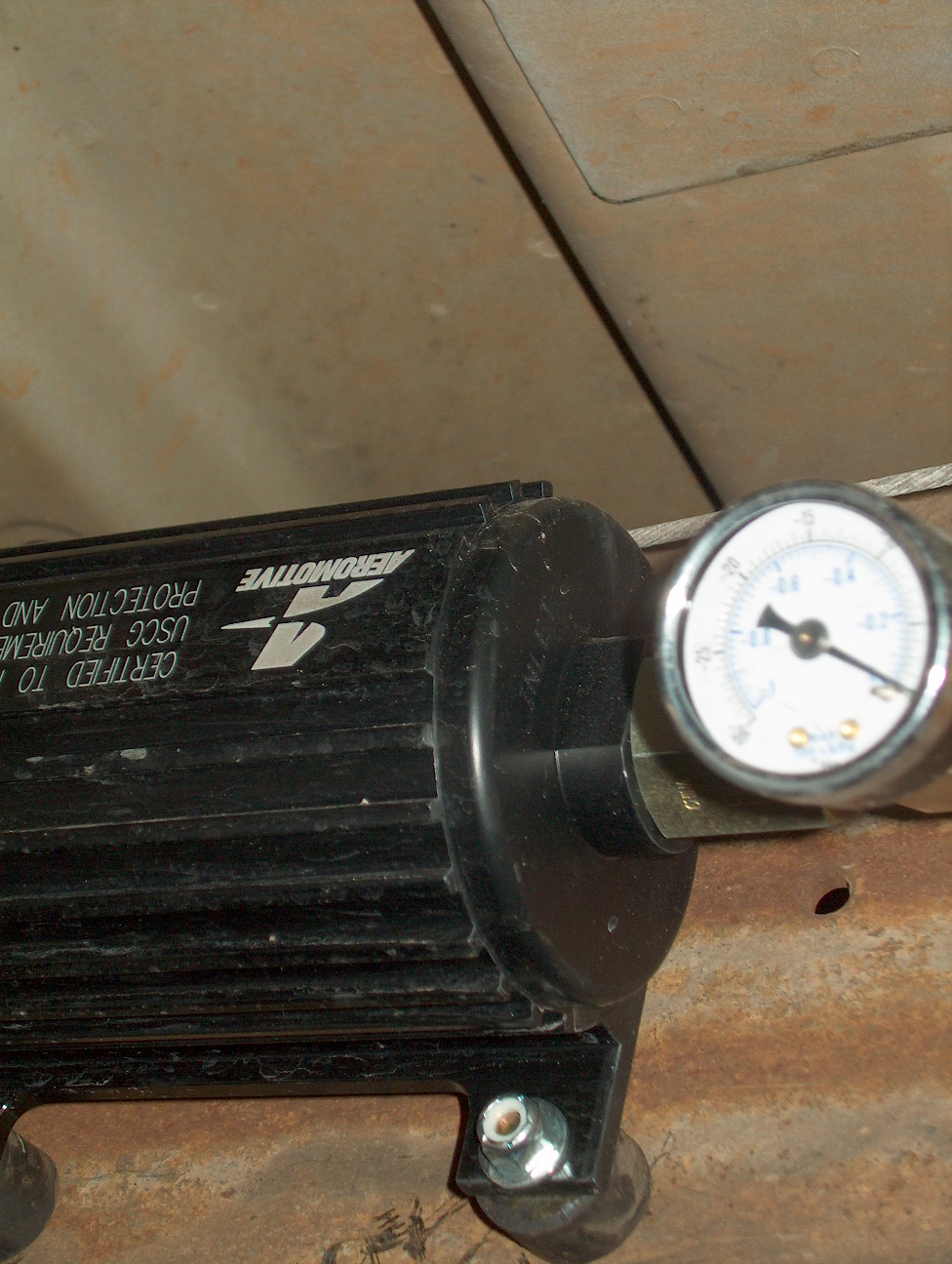

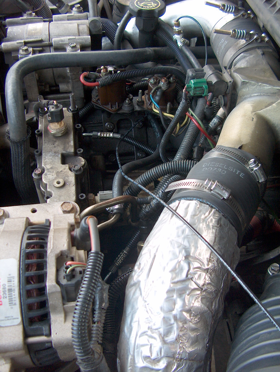

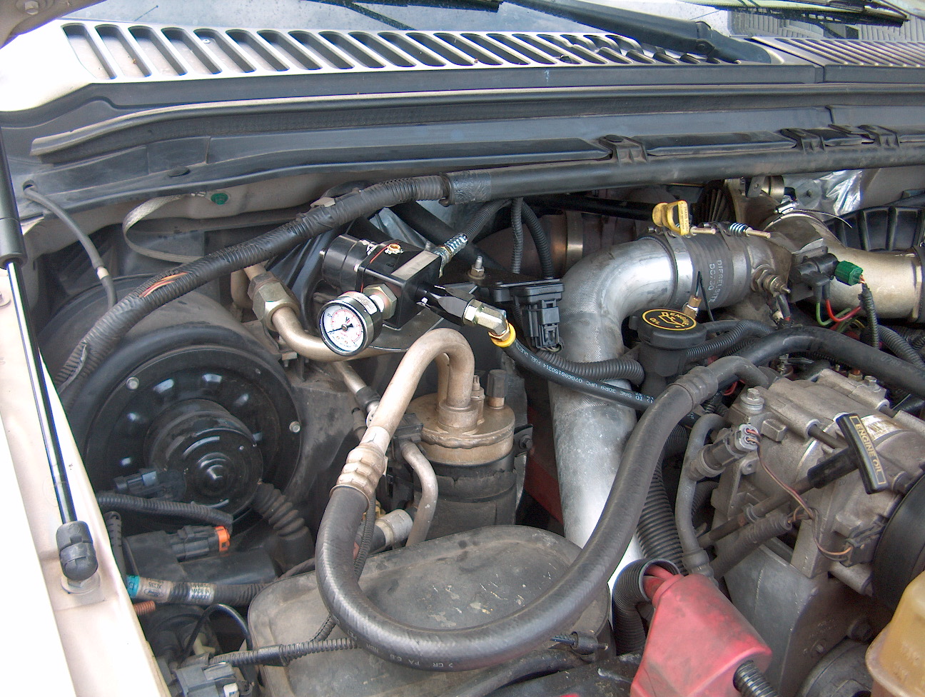

Pictures. Only 4 per post . . .
Regulator
Supply Line
New engine valley w/no filter.
Cooler and Seperator

Posts: 282
Pump
Ground Clearance
Regulator at idle
Pump pressure gauge at idle

Yep youll love it!!!! I have mine set at 60 lbs and with the hybrids I can barely get the needle off 60 going down a pulling track!! Even after taking injectors out a turn of the key and air is pushed right thru.
