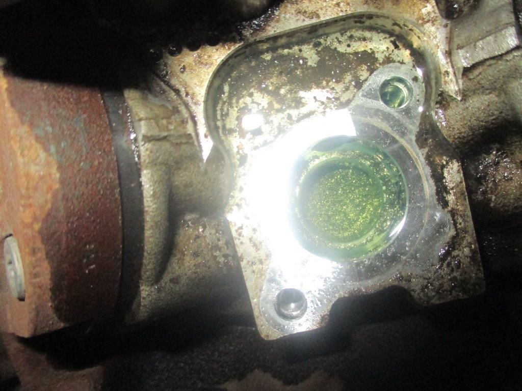

The vehicle in question is a 2012 F350 with 71,000km. While on a 600km journey the dash popped up the "reduced engine power" on the dash and shortly thereafter died on the side of the highway. It had to be towed to the nearest Ford dealership. It was last fueled up 80km before it had died
Ford performed their diagnosis and then informed me that a very large quantity of fine metal shavings had been discovered in the fuel filter, lines, bowls, pump, and rail. They also stated they would not be warranting this repair. The total estimated repair bill has come in at over $10,000 to replace all the lines, pumps, etc.!
I have included pictures of the metal shavings. Can anybody provide a plausible explanation as to where these shavings are from? Also how do these get past the fuel filter? I have read other posts of similar issues and if this is a failure of a Ford part then I would like to have that discussion.

You'll get better answers from someone else but I'd guess that is all from the high pressure fuel pump.
Ford will likely claim there was water in the fuel. A poor answer in my opinion.

search the internet for hpfp failure. The high pressure fuel pump self destructs sending the metal shavings through the entire fuel system. If it was caused by fuel contamination, then ford is correct in not warranting the repair. However, there are specific tests for that, including testing for water/rust, or accidental contamination with DEF, etc. Fuel contamination can be covered on your comprehensive auto insurance, no differently than vandalism in a lot of cases.
If ford has already told you they wont cover under warranty, then they either found water or def in the tank, or signs of it in the fuel system.

Looking at the last picture, the part they took out is full of rust which means fuel contamination (water/moisture in fuel). Whether a tank of water or the big discussion on here and other forums on water in the fuel that is basically blended in with the fuel therefore not triggering the WIF light.
As stated by djousma, the High Pressure Fuel Pump is AFTER the primary filter so if it grenades after the filter, some of the access fuel not used gets rerouted back to the tank and will be caught by the primary filter however it is already too late because it as already done a full loop.
The 2nd picture is hard to tell what it would look like since it is still wet from fuel. If it is dried off, my guess is that has rust on it as well.
As I stated in a separate thread, everything you need comes in a kit from Ford. Ford simplified the ordering process for fuel contamination for the dealers. The kit can be had for about $3,700 online from the discount FORD dealers and the book lists the repair at about 17 hours. You should be looking at a $5,500 repair if you bring them the parts. What they are doing is charging you for the parts SEPARATELY instead of passing the savings on to you and charging you for the kit.
Here is the kit: EC3Z-9B246-A $3,084.15 (plus core charges that you would get back).

Regardless, taking the filter out of the equation, $3,989 for the parts needed plus labor. This is 10% above cost so true cost to dealer is about $3,590.
I remember reading from someone going through this that they took the kit part number to their dealer and they flat out told them that they will order the kit but still going to charge him for the parts individually. Considering cost is $3,600 and labor is $1,900, they are looking at $5,500. Anything above that is pure profit. I understand dealers need to make a profit on service BUT $5,000 on a day and a half job is ridiculous.

Yes, the last picture of the pressure regulator shows rust forming on the steel.

Not that it matters at this point, but how often did you drain and check the primary filter for water? Did you use any fuel additive like Stanadyne or similar? You situation definitely sucks, but there was water in the system at some point.
