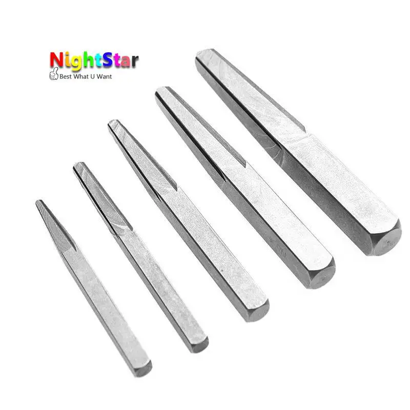

I wouldn't presume to argue with Bismic but you may not need to pull the valve cover. If you have a square easy out that just barely fits in what's left of that sender it should come out easily. Its an ORB fitting so its not really all that tight.

If you've got something sticking out of the valve cover that you can get hold of just put a vice grips on it and take it out.

Sometimes a needle-nose vise grip can get in a tight spot and have more room to rotate than a standard vise-grip and if the needle-nose is still too big then You may have to pull the valve cover to get access to some remaining portion of that sensor!

We are all here to help! If it looks like he can get some bite, then go for it, but IIRC the opening on that bottom portion isn't very big. Even so, maybe you could get a small EZ-out in it.
The way the valve cover is "indented" for the sensor (and the way the break appears), it looks to me like it would be tough to get a hold of what is left in. I do think (hope) that you could get a bite on the threads w/ vise grips w/ the valve cover off.
If the valve cover is pulled, then be very careful for sure - spread out some paper or cellophane to catch any small parts that may come off (if there are any).
My concern was that it was put on too tightly, otherwise it shouldn't have come apart. Maybe it was a defective part though.

You know, the more I think about an EZ-out, the more I don't like it. It always seems to generate shavings and you don't want metal shavings (even small ones) dropping through the sensor hole - at least I wouldn't.

That was my original concern as well. I wonder if there is away to alleviate that concern? I imagine, when I try to get a hold of the plastic male part, it may break as well but I'm assuming the sensor hole isn't extremely large and those pieces won't likely fall through. Then if the rest of the sensor, minus the metal housing, can be pulled out, maybe I'll be able to put some type of putty or lock tight type of stuff to stop anything, shavings, from dropping through when using the easy out?
