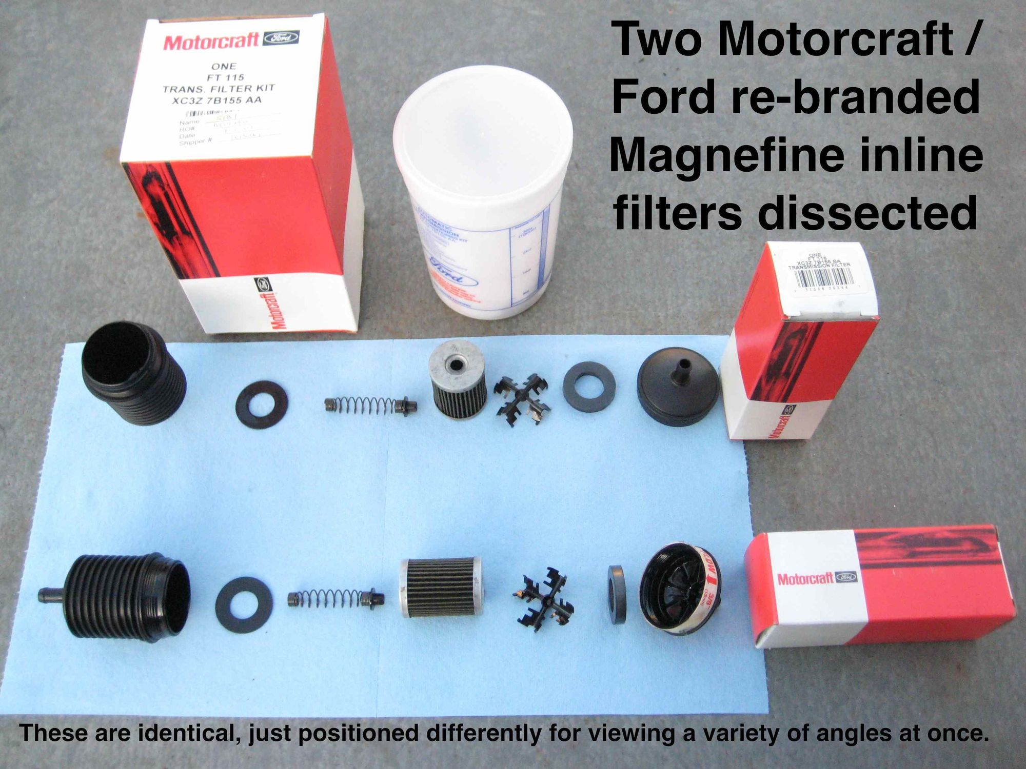

The difference between the 7.3L auto trans cooler, and the V10 auto trans cooler. Photo taken in year 2000, long before this became a "mod" popularized on the forums. Yes, even before Brian at BTS did it. And long before the 6.0L coolers came out. But I still lost this hand. Oil to Water is definitely a more efficient way to remove heat, and while I did add the OEM OTW cooler (by installing a new radiator) with this upgrade, the total surface area of the OEM OTW in tank cooler is much smaller than the custom OTW cooler shown by Googs in his pics above this post.

So if it clogs can that spring let the fluid flow?
