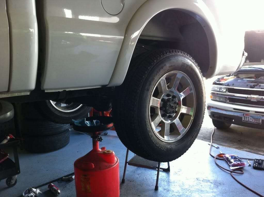

The project began on Saturday.
Out with the old. In with the new.
2 weeks ago I found a donor truck. A 4wd 2006 F250 that had been stolen, engine and trans removed, and dumped. The salvage yard put an ad on craigslist so I boogied on out there.
The yard was instructed to remove the axle (3.73 gears), radius arms, radius arm frame mounts, springs, spring buckets, shocks, track bar mount, and steering stabilizer mount. They were further told to not cut any brake lines, electrical wires, or vacuum lines. And asked to collect all bolts removed in the process.

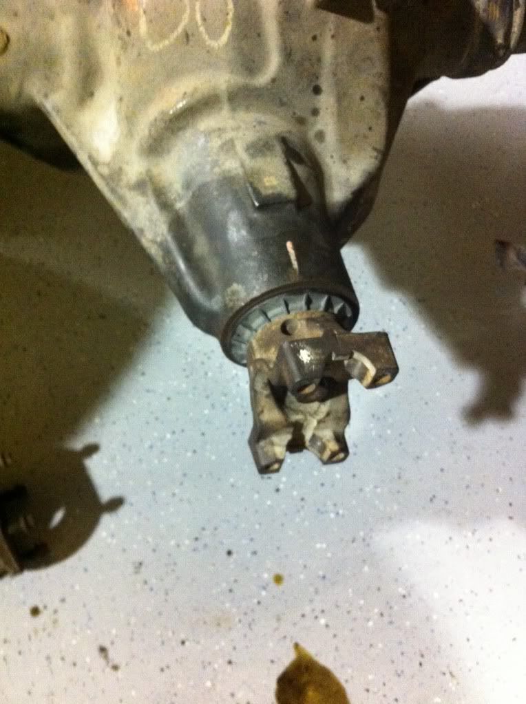

The rear axle came out and went back in with hardly a problem.
The yoke from the original 2000 axle didn't match the 2006 axle so we swapped them instead of modifying the driveshaft. The abs sensor in the pumpkin didn't match on the plug in side so we swapped them.
Shock mounts and sway bar hardware mounted up.
Old axle on the trailer...
New axle mounted with the 20" wheels.

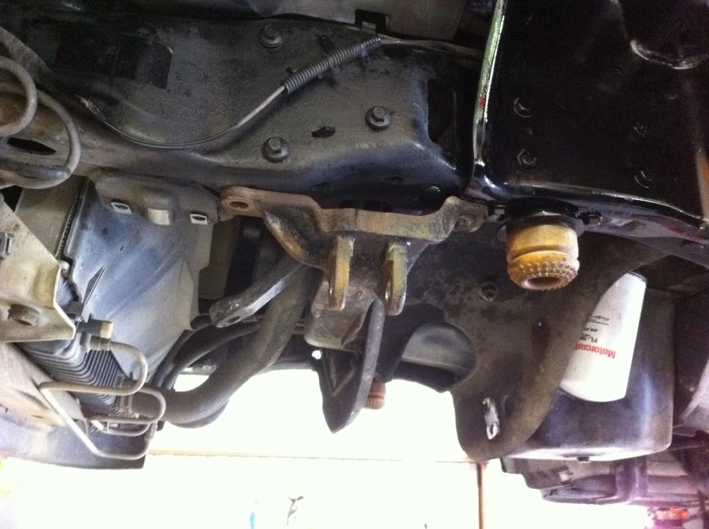

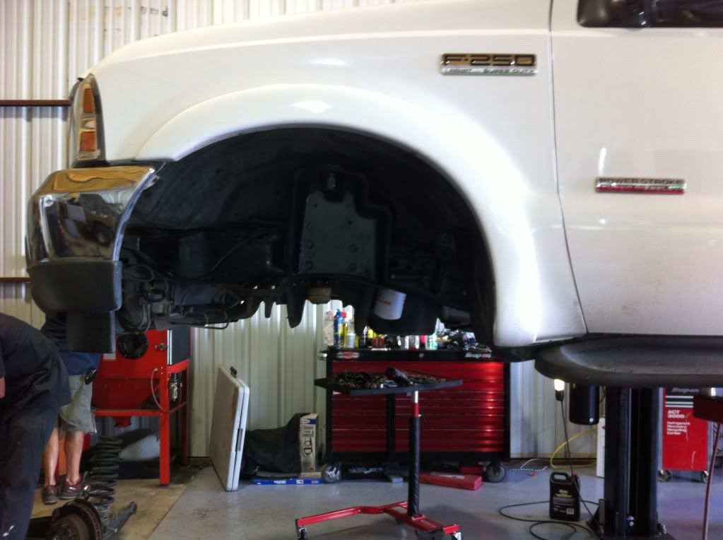

I was really nervous about the front end swap. From i-beam to coil spring. But so far my concerns were not substantiated.
With the old suspension in place, the radius arms and I-beams were unbolted from the frame mounts. Springs and shocks and the whole nine dropped right out with the hubs.
The radius arm frame mounts came out with bolts but the spring buckets were another story. With 6 rivets in place, those were a project in themselves. Grinding, torching, and air hammering was required to get those knocked out.
What a chore!
vegoilrecycler is offline
post #8 of 72 (permalink) Old 07-24-2012, 01:58 PM Thread Starter
Join Date: Sep 2008
Posts: 160
New spring buckets from the 2006 lined up with existing holes in the frame. So new grade 8 fasteners with locktite are holding them on now.
Next came the radius arm frame mounts, track bar mount, and steering stabilizer mount.
For the radius arm mounts, they bolted right up to existing holes.
The steering stabilizer and track bar mount needed new holes drilled in the frame but these were easy to locate.

Veg, I'm impressed with your taking on this project, but I'm confused: the picture of the white truck on the lift in #8 looks nothing like the 2000 in your sig - badges look like an '03 or later 6.0 truck. I thought you were mounting '05+ axles on the 2000? Or is the truck on the lift the donor? It looks pristine - why not buy the donor and mount your 2000 7.3L/ZF-6 veggie set-up in it?
