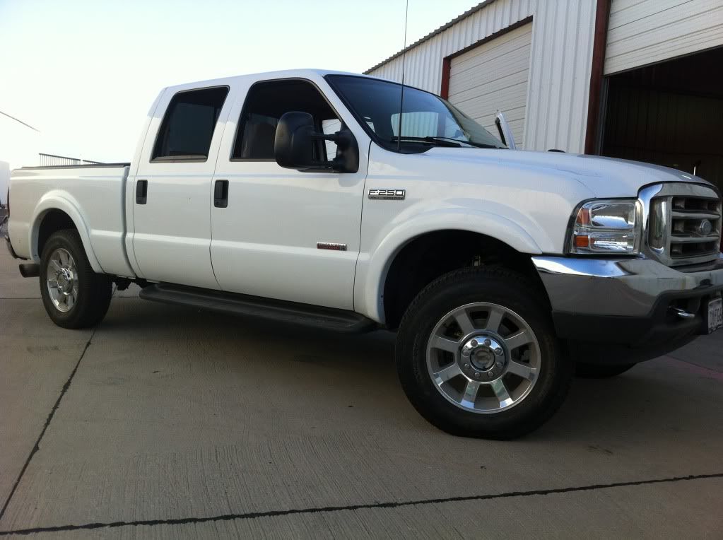

Originally Posted by Riggodeaux View Post
Veg, I'm impressed with your taking on this project, but I'm confused: the picture of the white truck on the lift in #8 looks nothing like the 2000 in your sig - badges look like an '03 or later 6.0 truck.
Judging by the oil filter I see under the engine, it looks like a 7.3 truck with 6.0 badges.
2002 F-250 CCLB 4x4 XLT, 7.3, ZF-6 with Midwest Short-throw shifter, ESOF, 3.73 R&P, HPx line, FRx, Racor prefilter before pump, Amsoil bypass filter, Coolant filter too
txgp17 is offline
post #17 of 72 (permalink) Old 08-03-2012, 07:35 PM Thread Starter
Join Date: Sep 2008
Posts: 160
Veg, I'm impressed with your taking on this project, but I'm confused: the picture of the white truck on the lift in #8 looks nothing like the 2000 in your sig - badges look like an '03 or later 6.0 truck. I thought you were mounting '05+ axles on the 2000? Or is the truck on the lift the donor? It looks pristine - why not buy the donor and mount your 2000 7.3L/ZF-6 veggie set-up in it?
The truck on the lift is a 2000. I upgraded the badges after the original ones looked kinda tired.
The headlights are the '07 as well. But the grill and front bumper are 2000.

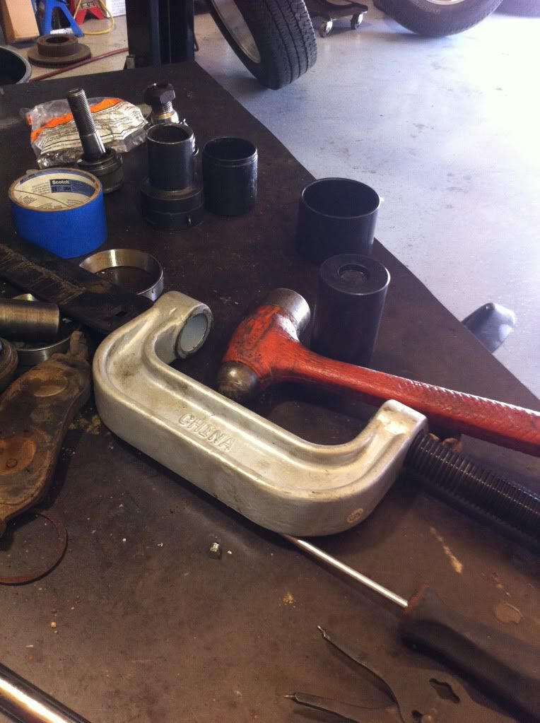

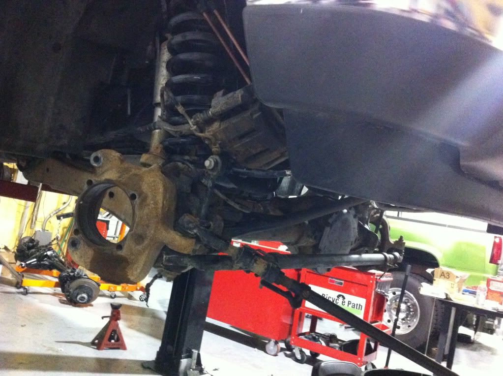

With the axle and radius arms together, we set it on the floor on wheels with the springs and lowered the truck down to it. Thank the LORD for a 10k vehicle lift.
The front axle got some work to bring her up to snuff. New u-joints (Precision), hub seals (Ford) and axle shaft seals (Ford). New upper and lower ball joints (Moog), and new EBC YellowStuff pads and a complete brake fluid flush with Dot4.
The original rear leaf springs were rebuilt with added leafs and re-arched, adding 2.5" of lift without the use of lift blocks.

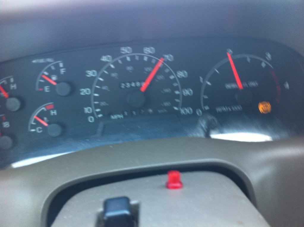

The truck has been my daily driver for over a week with only minor issues.
The speedo had to be recalibrated so I used by tuner for that task.
I took the truck into Firestone for an alignment. Toe was REALLY out and the steering wheel was clocked to 2:00 so the steering arm needed adjustment.
Check out the speedometer and tach. NEVER saw that RPM range at highway speed...

post #29 of 72 (permalink) Old 08-07-2012, 01:10 PM
Join Date: Nov 2010
Location: Greensboro, NC
Posts: 823
Did you change R&P ratio? That's the speed/RPM combo I have with 3.73's, 285x75R16's, and a ZF-6 (0.72:1 OD), 70 MPH @ 2,000 RPM.
txgp17 is offline
post #30 of 72 (permalink) Old 08-07-2012, 01:49 PM Thread Starter
Join Date: Sep 2008
Posts: 160
What is R&P ratio? I just programmed the wheel diameter using my Hypertech.
