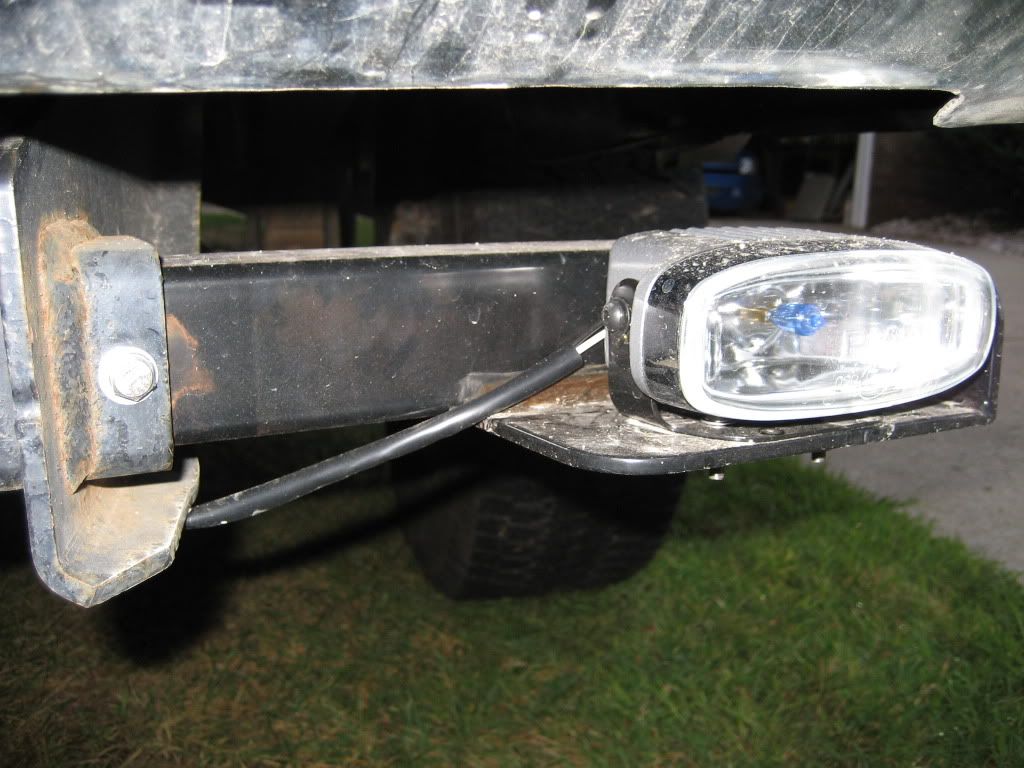

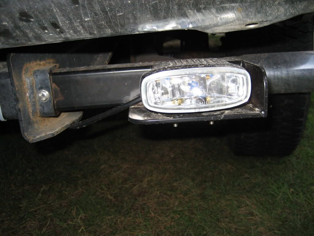

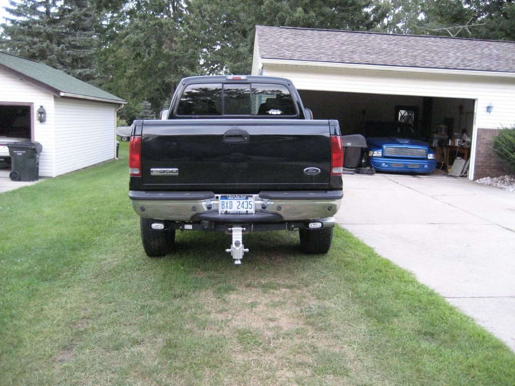

Hey guys, I just got done with my backup light install as well, Thought i'd share them with you. Let me know what you guys think!

Looks good, and might last around Snow Banks...

Yea. I do alot of snowmobiling, riding quads and taking my truck out on the dunes. Wanted something beefy enough to last and protect the lights as best I could. The tubing is 1/8 wall and the plate is 3/16 cold-roll, sure to hold up to anything i run over or hit!

nice dodge in garage svrd, that bad boy is riding low!

Thanks..lol... But she is doing more then ridin low...she'd layin' frame!
Here are some more pics of the Ram for you Acade, hope you enjoy ;-)

SvrdRam, Those are some STOUT brackets.
Good looking install, using the hitch tube was something I was thinking about, but installed mine a little bit forward on the vertical hitch supports just below the frame.

Thanks, wanted something that would hold up. Sorry everything was dirty in those pics but it rained earlier . Also if you notice the brown in the seam its black RTV. I stitch welded the inside seam, my powder coater (Bill) told me he's not sure how well he was able to coat the seam so I figured I'd add some extra security agaisnt rust.
