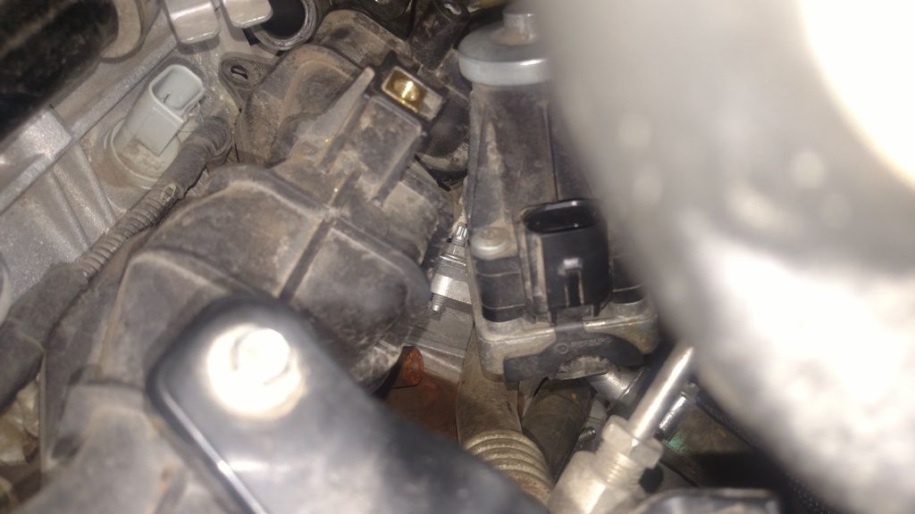

Descriptions precede pictures.
The EGR valve is in this picture. Really, it is. It has the grey top way back there behind the wiring harness.

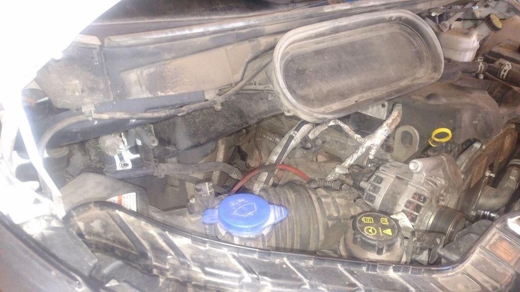

Way back in there is the other side of the cooler. From the blue washer fluid cap, go straight up and at the back of the head, you will see a black blob. That is the cooler. I took off the fresh air intake, but I'm not sure I needed to. Yes, it helped, but there isn't much to do on this side and in order to get it off, you have to remove the rain tray and if you take that off, where will you put your nuts?

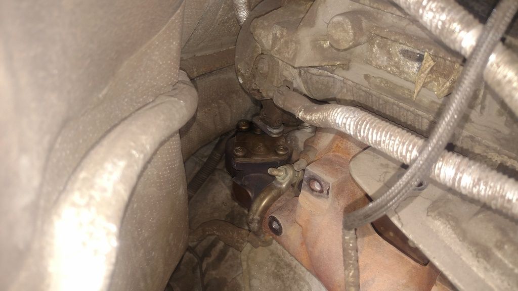

This is a view of the exhaust side with the heat shield removed and the vacuum line for the diverter valve moved. Three bolts on the heat shield, the vacuum line and the V Clamp is all that is needed on this side. The bolt for the clamp snapped as I was removing it. No rust, so I don't know why it broke. I suggest ordering it.
This is what I saw when I removed the clamp: Coolant running out. Definitely cooler leaking.
Between the valve and the intake manifold you can see one of the nuts holding the pipe to the valve. Mostly this was all done by Braille, but occasionally you can see things. you can also see the grey connection end of the cam sensor.

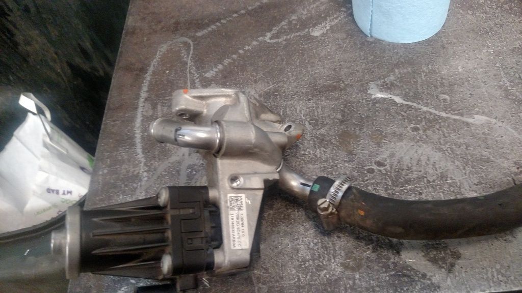

EGR valve. Apparently they just used this as a convenient place to support the hose rather than it being cooled.
There she is. Notice how clean it is on the right (outlet) side. There are just two bolts holding it to the head and both of them are relatively easy access from your right. There is a gasket on each end as well as the one on the bottom of the EGR valve. Ford says the cooler comes with the ones mounted to it, but be sure to order the one for the valve as well. And the clamp.
