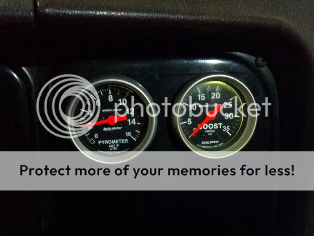

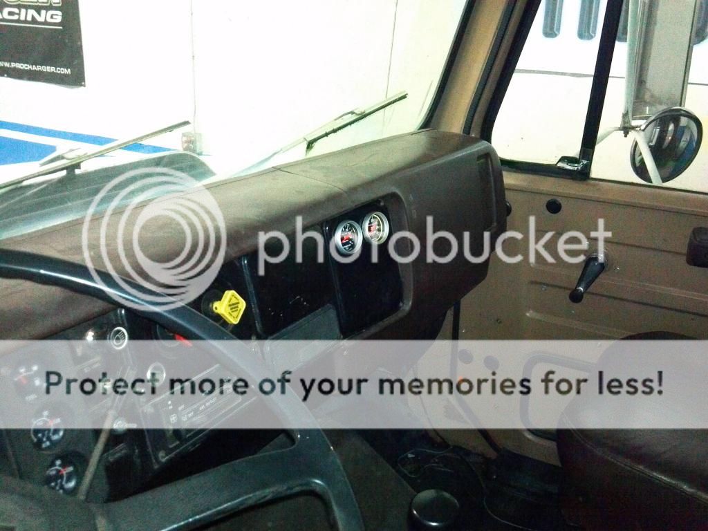

Here is where I put the EGT and boost gauge.

Gotta see what we can do to peg that booost gauge!

I know! I think 35lbs of boost would be just about right. Not sure how much boost the stock head bolts will take though. This boost gauge came out of my 08 Mustang. However, the Mustang only made 20lbs.

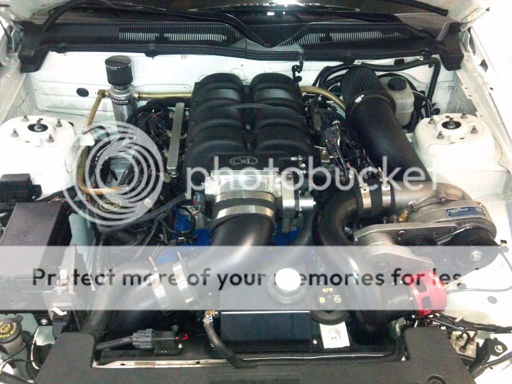

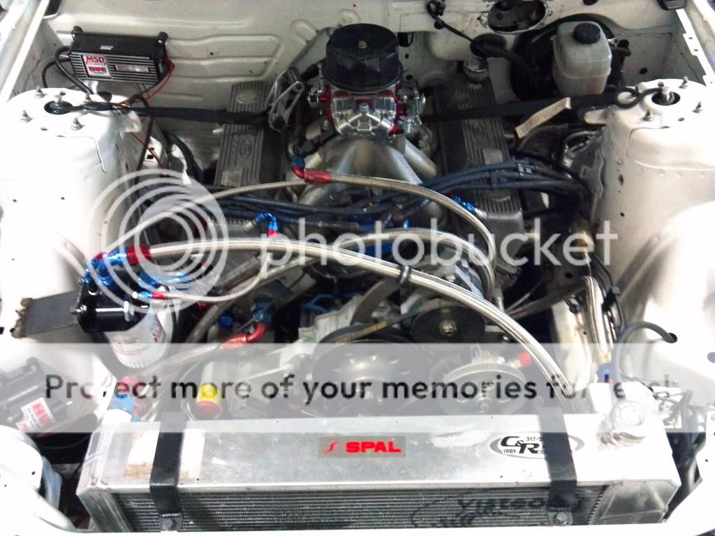

It had billet rods, forged 4032 crank, 2618 alloy forged pistons, ported heads, head and main studs. It made 724whp at 6600 RPM's on pump gas. Not bad for 284ci. I just sold this engine and bought a 800hp Sprint Cup 358ci from Yates Racing. This is the car the International will be hauling around.
