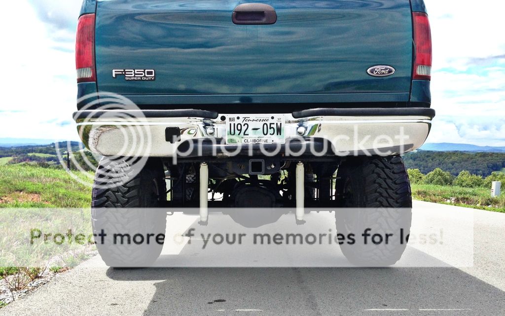

Alright fellas, I just picked up a 2000 F350 XLT 4x4 CCLB 7.3 ZF6 after being stationed overseas for 3 years and can't decide between the Pro Comp 6.5" and 8.5" lift kit. I had the 6.5" on my 99 and loved it. Had 16x10 wheels wrapped in 37x13.50 Interco tires. I am pondering going bigger so I can run 38x15.50 tires on some 18x10 wheels. Any suggestions or inputs welcome. From what I've been reading, it sounds like with the 8.5" I should be fine with the stock driveshafts. Maybe later I would think about getting custom driveshafts, but until that point, supposedly the stock shafts are ok. Any thoughts?

the other option if you don't what to go with the 8", you can take the 6" and add the bushwaker cut-out style fender flare. tha will give you plenty of space for 38.
I have only a 4" and i run the 37x13.5 with 2" spacer.
if you are going with the 8", i'm pretty sure procomp has a good kit and has everything you need to get everything lineup like it should. custom driveshaft will be a good idea later down the road

I don't plan on using fender flares so I just want to make sure I can clear 38s. I don't think the height would be the problem, but the width is what I'm worried about. I would like to go with 15.50 tires on some 18x10 wheels with 5 inch backspace. I THIIINK that should push them out enough so they don't rub on the leafs. Also, my 99 gasser was ligther than the 7.3 so it actually sat a little bit higher. Although with the 8.5" on the 7.3 I think I should still be able to make the 38x15.50 tire work. Thoughts? Anybody running this lift/wheel/tire combo?

finally got the lift installed; went with ProComp 8.5" lift; it came with everything except extended brake lines; the shop had to order a set of steel braided lines to finish the lift; all in all I love the look; I think for a CCLB you need the extra few inches for it to look proportional IMO; the front shaft ended up being too short so it's at the driveline shop now getting extended shafts

it surprisingly rides good going down the highway; real smooth and no steering wheel shake or wobble; I went with the BBs for balancing and I think that is way better than the weights, especially for tires soo big
