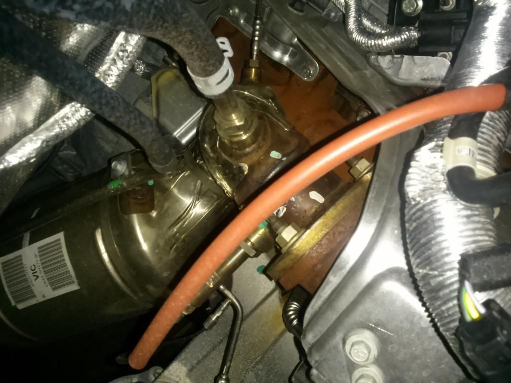

DOC right off of the turbo.

Apparently in South Africa where the engine is built, they don't have a rust problem, so they don't paint engine blocks.
