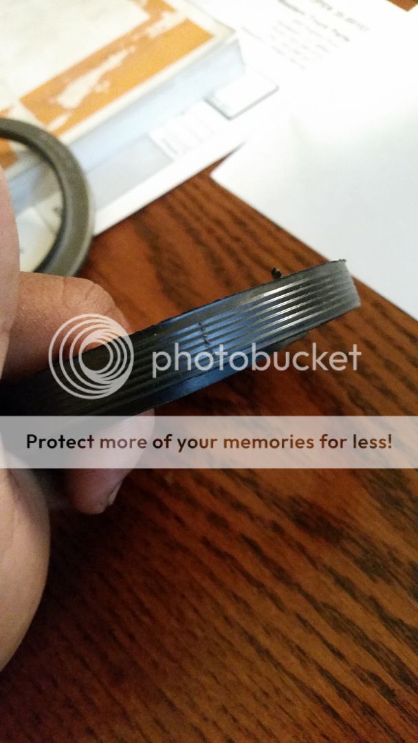

Installed the new seal with nothing on it as I thought about it too. The nicks were in the aluminium housing cleaned those up overall the seal install went very good. Buttoned her all back up in about 2 hours... seemed like it went back together faster than I took it apart. Test ran the truck and no leak... yet. The only thing I could find on the old seal was a small I mean small cut all the way across the outer diameter rubber. I'll link a picture. Other than that it seemed very clean. I did not grab the crank and check play.... wish I would have. Just got this truck so no chance to do an oil sample as of yet. The place I bought it from had changed the oil so I changed it again because I highly doubt they used the 5w40 synthetic. I used she'll t6 5w40 with a ford oil filter this time. I will do an oil sample when I change my oil next. It's a very good point about the mains it's a definite possibility. I do have the typewriter sound as tons of people seem to have after fresh changes. I'll keep you guys posted on what happens with more driving. The engine runs very strong I drove one of these for a few years at an old job I had so I can compare. It idles smooth ect so I don't think I've got a spun bearing. Matter of fact I know I don't because there was no shavings ect in the oil I put my finger in the drain hole (1/4 turn leakers plug) and found nothing. If I had a spun main I would have found a lot of metallic material seen it on plenty of large diesels.

update.... less than 50 miles and boom... leak. I have ruled out the vacuum pump that was the first thing i checked. looked at it with a mirror today while it was running and it is definitely the front main seal.
I checked crank play this afternoon and it seems very tight so im not convinced it is that. what I honestly think is maybe the dealer in texas didnt have the correct install tool so they winged it both times like i did and the install tool puts the slinger slightly off the seal by maybe 20-30 thousands maybe more... the slinger rides with the crank and the front main obviously sits still. maybe the slinger cooks the front main and causes it to leak..... being as i put the slinger on all the way. I checked with my local dealer they want 300 bucks to install a new seal. im going to have them do it with the specialty tool and well see from there I guess at that point then if it leaks its somewhat on them but if it leaks again after the proper tooling then we definitely have an issue.... praying to the powerstroke gods to not be crank movement....if it is... any one have the procedure to remove the cab? (in all seriousness)

the seal had been replaced at 118,508 miles and then again at 119.281 miles both times by the same dealer. i just replaced it again at 119700. I made two mistakes now that i got my local dealer to print me off the instructions.
1: i thought the seal was possibly a teflon seal so i made sure it was clean and dry no oil which in the service data i got it states to lube the seal with engine oil.
2 i didnt have the install tool.
