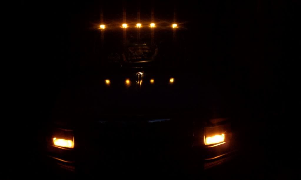

I recently just installed Recon cab lights on my 01 F350 Lariat. I tried going by Motoman's instructions, however those instructions did not touch a whole lot on the wiring part. And if you have a Lariat, you won't have the "extra" plug behind the kick panel.

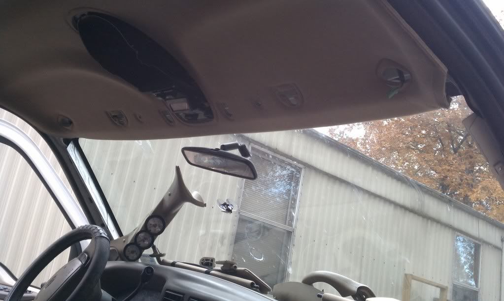

Once all of the holes are marked, I then took the a-pillars, visors, computer cover, and kick panel out. The 2 panel fasteners holding the headliner in place are a pain at first to get out. But if you start with a flat head to pry into it, then finish it off with a claw hammer its MUCH easier:thumbsup:. And the computer cover really wasnt that much of a pain. Pull down on the backside first, then pull down on the front.
Then its time to drill the holes I marked. I opted to cut the plugs that came on the harness and lights and go with regular connectors, because I do not have a knock-out set. I started with a small bit for a pilot hole then finished it off with a bullet bit. If you do not plan on having the roof repainted I suggest getting a knock out set. Now for marking the holes for the bolts I had made photo copies of the base of the cab lights (had to remover the bottom pad). I cut it out and put holes in the center of where the bolts go in. I lined the back screw hole (screw to hold the lense) with the center line of the hole, then I marked where I had made the two hole in the paper. Drilled those holes and then I was done drilling.

Hope this helps anyone in the future that finds themselves googling the internet because they can't find that extra plug:thumbsup:

Rammertide, I know this post is somewhat old now, but congrats on the cab light install! Thats one of the things I love about the superdutys, really makes them stand out.
In the picture you have of the interrior, is that a factory overhead console? I have been wanting to put one in my truck, would be really nice to have since mine is mostly a bare bones truck.
