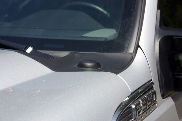

Why not just acquire a new factory antenna and cable and place it on the front of the dash... or out onto the cowl... leaving the antenna in place. Just disconnect one and connect the other. Easy to restore factory when you sell or trade the truck in for a new one.
39 Posts
This is what I did, Just bought a new cable and Ant and mounted it on the Cowl, the ant unplugs under the dash above the brake pedal. Took me about a 1/2 hour to do the mod, the hardest part was drilling a hole in my new truck for the ant.

The mustard colored antenna connection on the late model Ford Super Duty is located on the drivers side kick panel just above the emergency brake bracket. Here are some pictures I got from another web site.
Bill

I had a new antenna installed on the left front cowl and it works great.
I had Ford do the install, as they had to order a new cable and antenna and take the dash apart. Since I have the Nav system, the install is a little different than those without the Nav.
If I remember right the cost was about $300.
Since I have a crew cab, the camper over head is not that much. If have a super or regular cab, the overhang would be greater and the antenna would probably have to move farther forward.
