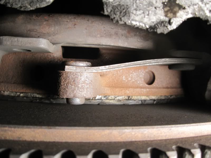

Here's the story:
I'm 50 miles into a drive going down the highway in 4th going 55 and I stop to meet a friend. 5 minutes later I'm back on the highway following him for another 20 miles or so when all the sudden I'm seeing smoke and smelling burned clutch. I drive for a few minutes and the smell/smoke continues and then it feels like I'm losing power. Putting on the gas just revs my engine so I jump off on a good pullout and theres smoke coming from under the hood.
I open the hood and let her cool and let the smoke clear =5 mins or so and then fire the engine back up. I have fuel spurting out of one of my injectors (the one on drivers side closest to firewall). So then I loosen, inspect, and replace the cap on the injector where the metal line runs in. I fire up the engine and presto no more spurting diesel.
So I think I'm good to go here and I throw her in gear and no go. The engine is idling fine and I can shift through all the gears in 2wd and 4wd without stalling the engine or moving 1". My clutch pedal action is normal and I depress the clutch, shift, release like normal, and the truck won't move.
Well I got it towed back to my garage and did alot of research on this forum as to what might be wrong.
Do I have a bad clutch?
Do I need to replace my flywheel as well, or can I get away with a resurface job.
I talked to a guy who says I might have gotten diesel on the clutch causing it to not work. He says to pull back the boot and remove thew inspection shroud and spray brakleen in there. Anything to that advice?
What I've done so far:
- pulled back boot & sprayed brakleen in there
- removed inspection shroud & spray brakleen, cranking the engine a little to make it turn and then spraying again -- see photos taken before application of brakleen
I wore out the battery trying to start it back up to see if my brakleen worked (its cold outside here still!), but I got a charger on it and will try tomorrow.
I'm trying to exhaust all my options before I run to Anchorage to get parts cause its about a 3 hour drive--so I want to get what I need when I'm up there- this is huge...

8,185 Posts
Not being there I don't have a clue how bad your diesel leak was but bell housing to engine mating surfaces are sure not water (or diesel) tight. If you did diesel-soak the clutch disc there's absolutely no way you're going to clean it up with BrakeClean unless you have the disc sitting on a workbench. And then who knows if BrakeClean would draw out all the diesel. I know it's NOT effective trying to clean up oil-soaked brake shoes. Best bet is pull the rubber boot back at the TO bearing lever, look in while someone depresses the clutch and check the travel, make sure there's no problem with the lever, its pivot, TO brg travel, etc. If all that's OK it's a safe bet it's the disc/flywheel ass'y. I've replaced many a oil-soaked clutch, but never a diesel soaked one---that would be a first.
