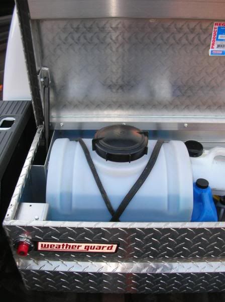

8Gal Tank in toolbox.

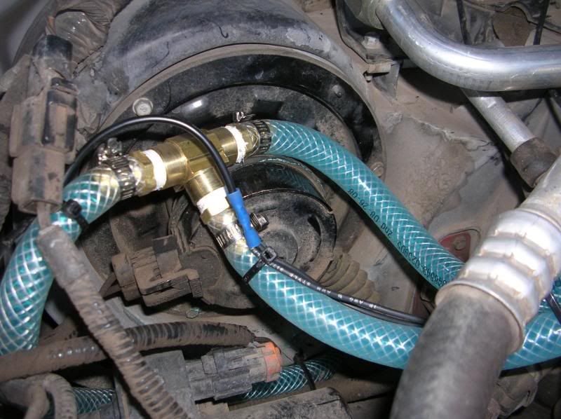

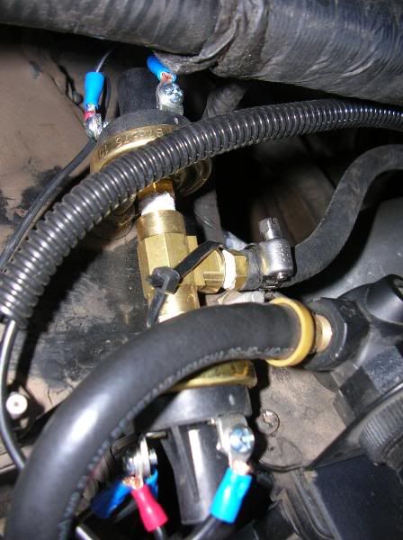

Pump placement under passenger side door on frame.
115 Posts
Hobbs switches. Low boost bottom, High boost top.
I would also like to find out what everyone else is running for nozzle size "flow per hour @ specific PSI" on their kits? Currently I am running my pump at 140PSI and seem to be getting a good fine mist from both nozzles. How do you know when you are spraying too much? I am still new to this and would like as much input as possible.
I have been running about 30% Meth with no plans to go any higher. I defiantly notice a difference when the Water/Meth is spraying.
*Please let me know if you would like any more information or if you have information please post up.

Nice job. How long does the 8 Gallons last you? So the low boost side sprays at 5 lbs of boost?
