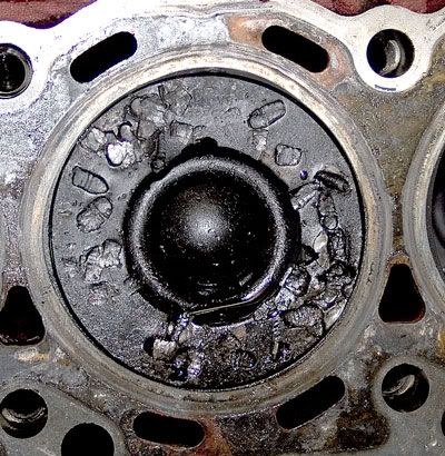

I had an old one and just broke off the tip. This is an OEM one from a 7.3 diesel: glow plug picture by galexander - Photobucket
Thanks TB! If you break off the tip inside the combustion chamber, does it pull the wire through with the tip?
(in other words, if the tip breaks off when it's installed, how much of the glow plug can be pulled through, into the combustion chamber?)
You notice the corkscrew on that piece sticking out of the top? I wonder if that's the "thread" impression on the piston crown?

I would think that wire could break off at anypoint, right at the tip or somewhere up the shaft and pull wire out.

Hey TB, thanks for the effort. We're sneaking up on a solution this question little by little. Can you take a couple of pairs of pliers, and just bend that glow plug tip (the engine side, not the connection side) back and forth until it starts to break off, then pull to see what comes through the end with the tip?
In other words, I just need to know what comes out of a glow plug, if the tip breaks off in the engine.
Thanks again.
44444444, you have been way too nice in this whole deal...what state are you in and what is the name of this dealership? If I were a betting man, I'd say the glow plug is your culprit, especially given the wire inside. Smash that glow plug tip and I'd bet that you have a winner with the shape on your piston crown, and now two glow plugs are missing, as is the wire.
If the mechs messing with this truck are reading this, YOU'RE A BUNCH OF SNEAKY, THIEVING %^&!!!!! Do this guy right and admit your mistakes!!!!

Here is another pic: glow plug picture by galexander - Photobucket
In that pic the wire is still attacked to both sides. I could see the wire breaking and staying in the tip or it could come out. There is some sort of insulation inside that breaks down to a powder substance when broken. So I don't think I gave you a clear answer. I guess it just depends on how it brakes off.

It would be interesting to know who is in custody of that wire. It would be easy and not all that expensive to have a metallurgy analysis done on it to determine if its Nichrome. And where those other two GP's are.
Heating element - Wikipedia, the free encyclopedia
The annular rings noted on the impressions of the object could be residual from the wire, edges of the valves or pistons combustion chamber. Some impacts show one ring, others show two.
It’s still my opinion that the object lifted the head and compromised the sealing surface.

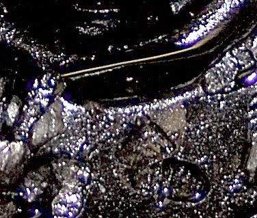

I did some work on the photos, but I can only boost the resolution and message the forum images so far.
Hey Jack, thanks for that photo work! I'm going to try to post the high resolution version below. If it works, take a look at about 6 o'clock on the piston....Do you see those embedded chunks with little pieces of wire sticking out of them?
As they said during the Nixon/Watergate trials.."IT'S NOT THE CRIME THAT GETS 'EM...IT'S THE COVERUP!" :lol:
Someone at the dealership INTENTIONALLY scraped this piston and removed the large wire piece, even though they told me that they COULD GO NO FARTHER without Ford authorization!
I don't usually pay much attention to internet conspiracy theories...I just wish this one didn't involve my TRUCK!:lol:
Ok, this is better, but I'm going to blow up the 6 o'clock area and see if I can make the pieces more visible..
