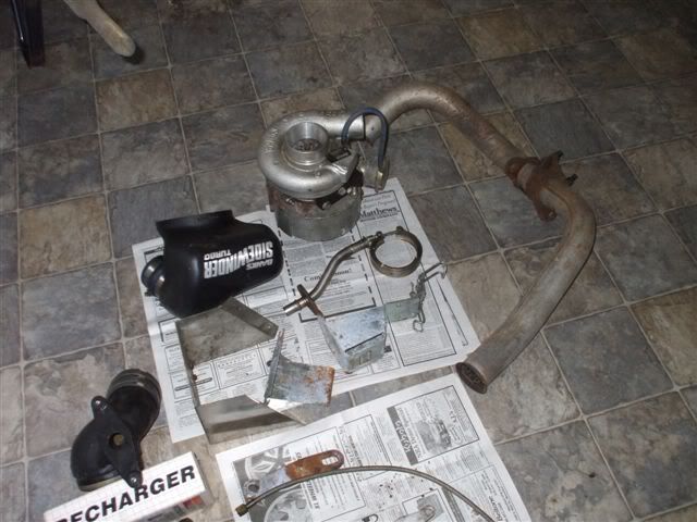

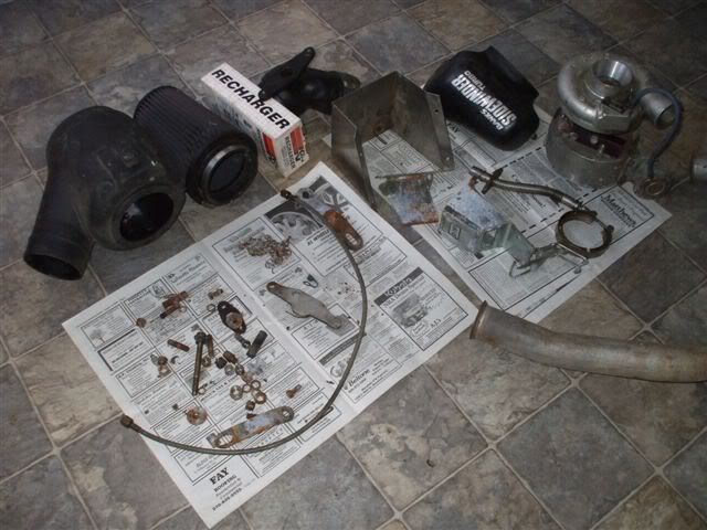

So I am buying a banks sidewinder turbocharging system from someone on the forum. I have two pictures of everything I am getting (paying for). I am buying boost and EGT gauges seperate... BTW My question to all of you guys is: From these two pictures, does it look all the installation parts are there, if not can I order just the nuts/bolts/screws/ect.. in a kit. Is it missing any MAJOR pieces? Let me know what you think.
Thanks.
1,744 Posts
Sorry to say it but you are missing plenty. First off the cast iron up pipe from the exhaust manifolds that the turbo mounts to is not seen in the picture. Neither is the rear mounting brackets or the glow plug mounting plate. You also need some heat wrap for the down pipe that I don't see either. Banks may have the parts but they are discontinuing the sale of these turbos and parts. Give them a call.

Does anyone have any of these Banks Turbo pieces they could sell me for cheap, so that I don't have to buy them brand new straight from banks. 360 dollars for a mount and 100 for a pipe 1ft long seems expensive haha.
Here are the missing parts and part numbers I need:
#5 pn 92853 clamp #6 94283 hose
#17 52102 pipe
#24 52158-00 turbo casting mount.
#31 63042 probe
#35 92837 clamp
#51 94507 hose
#57 93153 0-ring
#58 92816 clamp
#59 94044 hose
#65 52147 bracket
#69 94042-00 adaptor
26002 heatshield 7x24
26004 heatsheild 3x16
Thanks guys.
