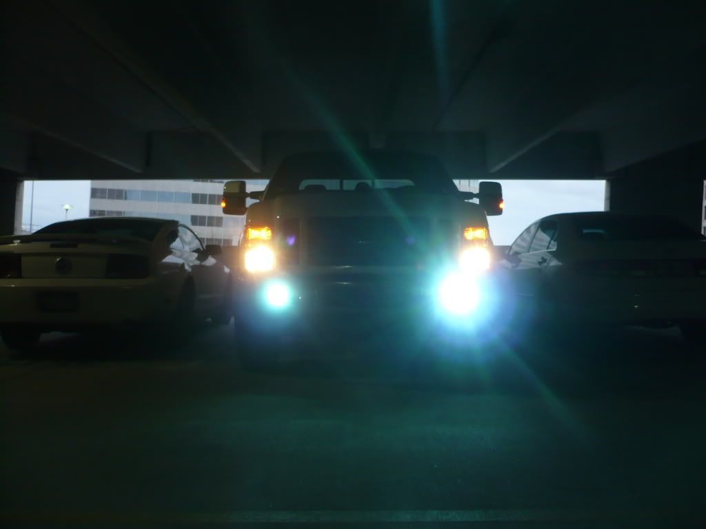

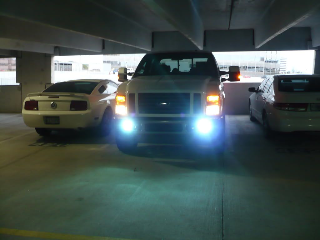

I got my HIDs today and began to install them. Seems like im going to need some relay harnesses though because the headlights wont come on at all and the fog lights only come on when the truck is running.
How many here who have installed HIDs in their 08+ needed the relay harness?
605 Posts
I only have them in the headlights for now but i have issues sometimes one wont turn on. But when the fogs are on they wont come on at all. Maybe try running with the fogs off and then the headlights should turn on, I was told some trucks have to have a relay kit to work right.
one thing i am going to try first is replace the fuse with a slightly bigger one.
2,269 Posts
Are you guys using the plug and play connectors? If the HIDs won't turn on it's because they can't pulse enough amperage to them fast enough. They are really high amps for the first split second then drop way down. I used the gay plug and play connectors when I first got mine, and they just wouldn't allow them to figure up. I eventually installed some relays and hard wired everything and now it's fine.
