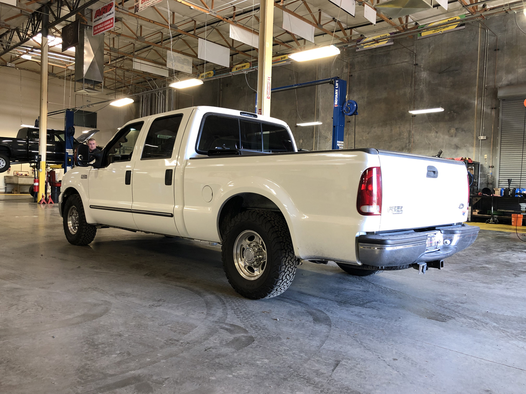

The truck came to me with:
"USA" Turbocharger (horribly laggy)
Unknown Fuel System (DI maybe?, old for sure)
Very Old FASS HD pump
Sniper Chip
AFE Stage II Intake Kit
Banks Power Elbow and 4" Exhaust
ISSPRO Gauges
Bunch of Modified Wiring (engine, headlights, etc)
Stock Lariat Wheels with BFG ATs
Welded in Gooseneck and Receiver Hitches (grrrr!)
2005+ Nose Conversion and Reflexxion Cowl Hood
Backflip Tonneau Cover
Here are some "as received" pictures:
The outside of the truck shows 20 years and 176k miles of driving. It is dirty underneath, there are small dents in the sheet metal, the paint is not great...pretty much what you would expect. I bought the truck because the interior was really clean for its age (from what I could tell in the pictures), and so far I haven't been too disappointed. The engine did have a noticeable miss when cold, which was significantly improved with a BG oil treatment and bottle of HSS Stiction Eliminator (enough of a bandaid to tolerate driving it for a while). The trans shifts extremely hard, and I'm not 100% certain why, but we did find 2 broken springs in the valve body that have been fixed (but it hasn't driven yet). Overall, it will be a solid base for a "restoration/modification" project.
