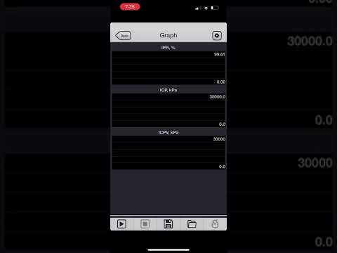

Discussion Starter · #7 · (Edited)
So here is a reading for both he ICP plugged in and then unplugged. The one on the left is with it plugged in. Looks like the IPR fluctuates quite a bit and dips when it gets throttle. The one on the right is the ICP unplugged. IPR stays right at 12-14% with throttle. Appreciate all the help with this. I am not sure what these numbers are telling me but learning! haha
11 Posts
Replaced the ICP pigtail and it did exactly the same thing plugged or unplugged.
I am really leaning towards the PCM not properly reading the ICP when it is plugged in and thus, miscommunicating the pressure to the IPR. The IPR seems to fluctuate and not be stuck, its just going to the wrong numbers. When it is plugged in, the PCM defaults to about 12-14% IPR and it runs just fine. Is that possible, am I on the right track?
