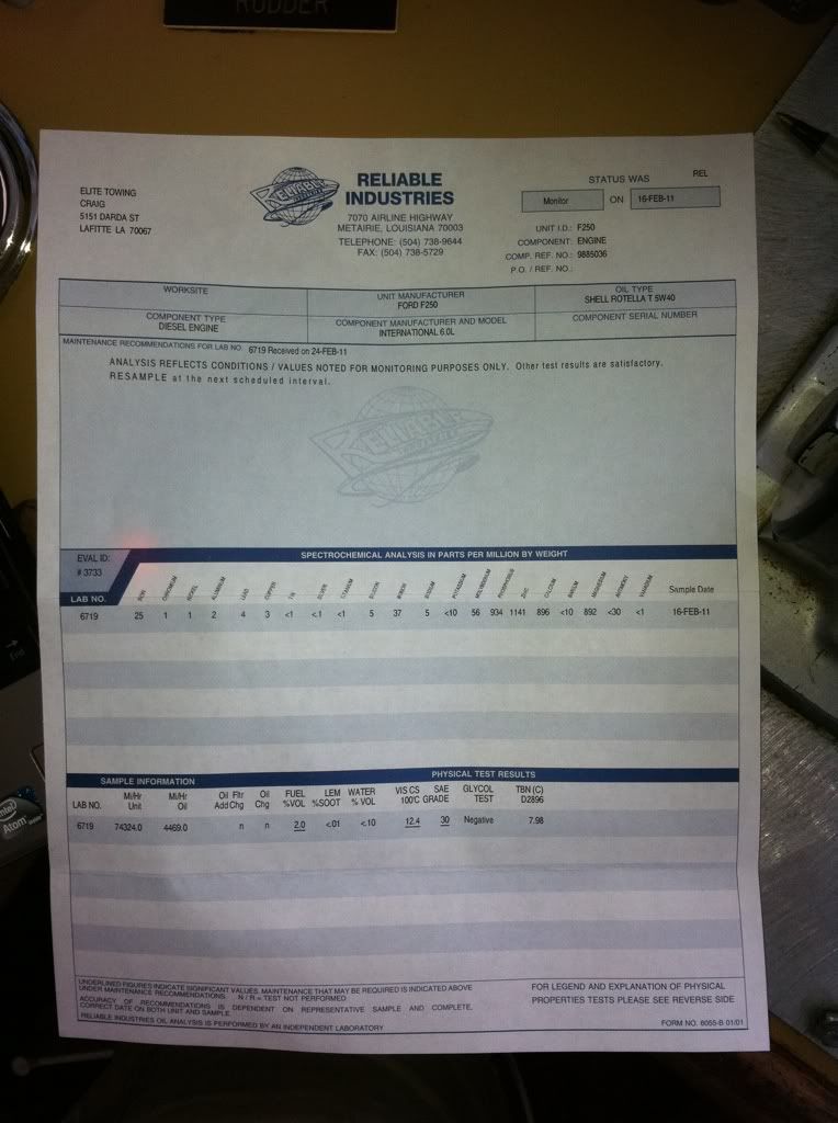

What can I look for. Also when changing stc fitting do I purchase cover orings? anything else to change after removing hpop cover?
Below is my parts list which will include coolant filter, egr delete, EAS fuel press sensor, ELC coolant, restore/restore plus.
(1) Fuel press spring 3c3z-9t517-ag
(1) Oil cooler 3c3z-6a642-ca
(1) Stc fitting 4c3z-9b246-f
(1) fuel bolt w302472 "as long as 2 are in pack"
(1) fuel bolt washer w303659 "as long as 2 are in a pack"
(1) thermostat 3c3z-8575-aa
(1) turbo drain 6c3z-9t515-a
(1) intake gasket set 3c3z-9433-be
(1) turbo supply 3c3z-9t516-a
(1) turbo clean kit 4c4z-9v424-aa
Anything else I may need. Thanks!

I had a 2% on one of my UOA's. It turned out to be the fact that I had started the truck and moved it just prior to changing the oil. The engine was already at operating temp and only ran for under a minute while I moved it. I just wanted to get the truck closer to my garage. The 6.0 dumps a lot of fuel into the oil on start up.
Best thing to do is get it at operating temp, shut down and drain the oil right away.

I took the sample using a plastic tube down the dipstick tube while engine was running, never took one since, now the equipment is on the tug boat but I suppose i could take it through the fumoto valve?
Thanks for the reply!

Best to take the oil sample from the oil pan drain plug about 1/2 way through and as I said above with the engine at or close to operating temp.
