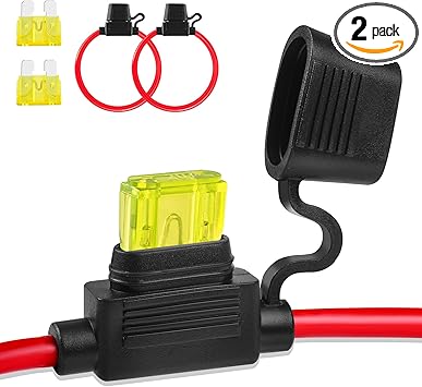

Thanks Glen. So it sounds like even though my lights will only draw 5 amps, I will want to run at least 10 gauge wiring (because of the assumed length), run from the battery to the switch (with a 15A inline fuse between the two), then run from the switch to the lights. Does this sound correct? Will the fuse get both the positive and negative wires run through it?
Discussion starter · #31 ·
I would just purchase a 15 ga extension cord down at the local hardware store. Then head over to a auto parts store and get the fuse holder and associated wire eyes that will be needed to connect the wire to the positive battery. I believe that your 2001 has a fender mounted relay where the battery cables terminate, you can connect the wires at this spot.

Thanks for the help bud. Just so i understand, there will be 3 wires in the extension cord (Hot, Neutral, Ground). Hot Wire - I will run the hot from the battery/relay to the switch, putting the 15A fuse between them, then from the switch, I run the hot straight to the red wire on the lights. Neutral Wire - I will use this as the negative wire that connects to the black wire on the lights. But where does the neutral connect at the beginning under the hood? Ground Wire - I can ground it under the hood and also at the rear on the frame?
Your whole truck, frame, body, and any metal is a ground. This is why any voltage measurements are taken to a grounded piece of metal. For the most part the only time that you need to supply a ground is when there is plastic involved in the part that you are mounting the light to since plastic doesn't conduct electricity.
Technically you only need a single wire to the lights that has power on it. Then on the lights you just ground one of the light wires to a mounting bolt for the light. If you want to your can just ground one of the wires anywhere near where you connect into the battery power and then connect that wire to the second wire on the lights.

Ok thank you, that clears it up. Run hot wire from battery to switch then to red wire on lights. Ground wire grounded under hood near battery and run straight to black wire on lights. The inline fuse holder and switch are only connected to the circuit by the hot wire. Does this sound right?
Now you got it
