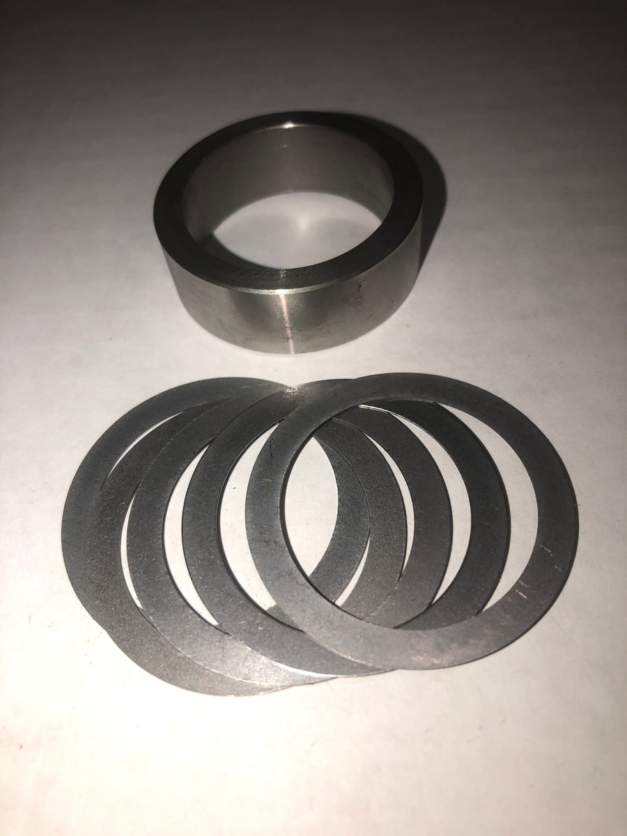

I didn't feel the need to install new gears in the front axle, because there was nothing really wrong with the ring and pinion part of the axle. 4WD rarely gets used, so the mileage on that axle is quite low compared to the rest of the truck. I therefore decided I would replace bearings, races, and seals, and just reuse the stock ring and pinion. When disassembling the axle I discovered that for some unknown reason Ford decided to use a crush sleeve in a Dana axle. One of the Dana series inherent strengths was NOT using a stupid crush sleeve. A crush sleeve is only beneficial when they are building the axles on the assembly line. A solid spacer using shims to set pinion bearing preload will never back off, doesn't move under shock loading, and allows you to change pinion seal without the need to crush a new crush sleeve. Unfortunately you need a special solid spacer kit for the Ford Super 60 to eliminate the crush sleeve, because the pinion surface where the shims would go is farther back on the Ford specific gearset to account for the crush sleeve (ordinary D60s just use a couple thin shims). I bought this kit to solve that issue:
