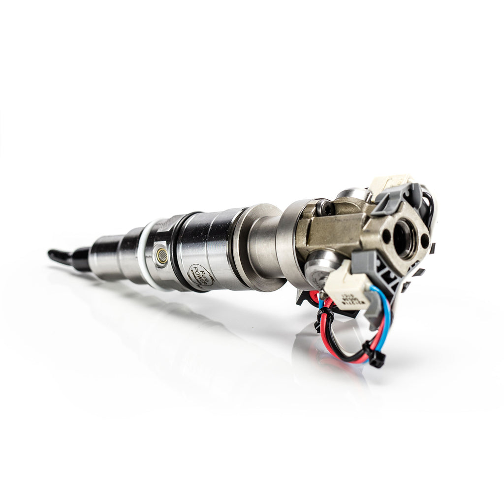

Once the heads were installed I went ahead and installed all new Motorcraft GPs. I also installed the injectors, which are RCD 175/30s. I sent them back to RCD to have them cleaned and tested, and they came back looking brand new with a clean bill of health. Here's one of them prior to installation:
Its worth noting that I put some clean engine oil on the white and black o-rings prior to installation. I also put a little grease on the blue o-ring for the connector (it makes removal easier I've found). I have the older T-40 hold downs. I cleaned them all up and installed them with the injectors. I torque these to 31 lbs/ft., which is more than the original spec, but Ford revised that due to some coming loose. I've installed T-40 hold downs with this torque for 10 years and never had an issue. Of course, I put a little oil on the threads so the reading is accurate. Here's a pic after they were all installed.

A couple of things. First, looks like you are new here, so welcome! Second, you'll get better responses if you start your own thread, or you can always PM guys like me and bismic directly. Third, if you have a single injector that's bad I would advise you to replace at least the 4 on the bank with the bad injector, but really I would replace all 8. My reasoning is simple, its a fair amount of work getting to the injectors. Swapping a set of injectors in about a 4-5 hour job for me, and I've done it several times. All the injectors are likely the same age. If one is bad now, how long before the rest follow? Ideally injectors are also a matched set, though if you are just swapping out stock ones it less important than with aftermarket ones.
As far as buying new ones, I have been buying larger injectors from RCD. I feel they have first rate quality, and they stand behind their products. Here's a link to their reman injectors from Alliant Power:
I believe that to be a good price, especially for the quality AND considering the 2 year warranty. If you need anything else feel free to PM me.
